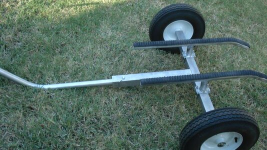

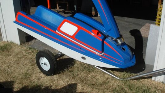

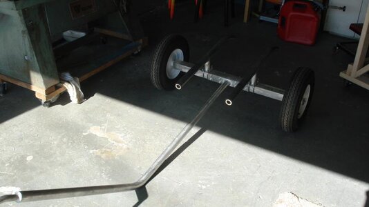

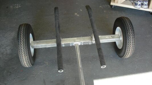

This is a prototype of the Beach Cart I've been working on. It isn't finished, but I wanted to post a couple pics and let you guys see it and give me some feed back and opinions. It's very stout and utilizes rollers rather than bunks.

This will might be moved, but anyway. For me, the rollers are a negative. I want the ski to be able to rest on the cart! I prefer the slight friction of carpeted bunks. Rollers seem like an opportunity for trouble. Otherwise I like the simplicity of the design and the price point. Will the handle be detachable?
Thanks for the reply
I know what you mean with the rollers. There is a tie down that is part of the system, and must be hooked up. Otherwise your ski will send the cart rolling across the yard! LOL The handle is detachable for shipping.
Bunks aren't completely ruled out, but even small bunks didn't seam to prevent from slipping underneath.

i like the design, just need something to thold the ski against the bumper at the pole. easy load/unload. low profile to the ground, less lifting.
I'd be concerned tha the "T" design may not be strong enough, and it doesn't appear to offer a straight forward means of break down for storage/transport.
otherwise i like, would like to give it a shot.

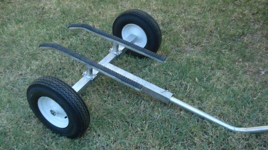

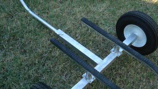

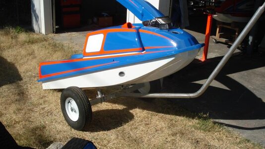

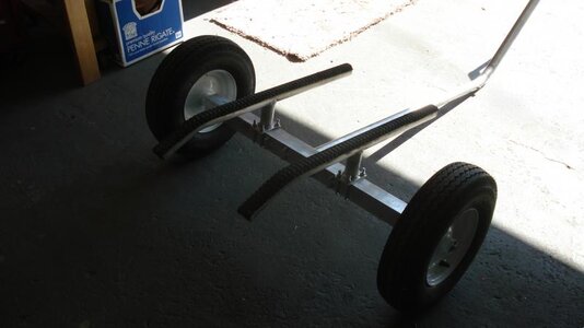

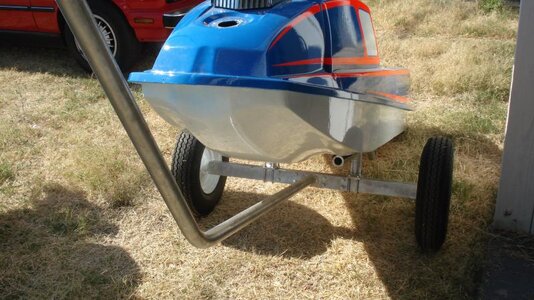

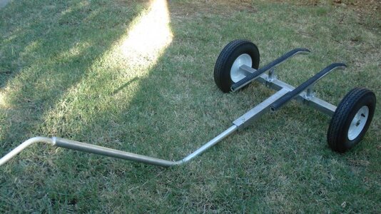

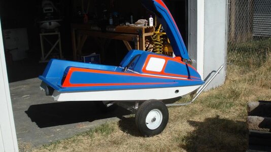

I decided to toss out the rollers due to liability concerns. I made up some burly bunks out of .25" thick aluminum and the seam to work nice. I bent the handle further and welded in the handle piece as well. The bunks are turfed and grip the ski quite well. The ski weight can be easily centered and it can be tipped to rest on the front or back without any sliding. This could of course change with wear and tear, and water. A loop or soft tie will be included to hold the ski by the nose. The overall center of gravity is nice and low and should help with the "log rolling" problem of having the bunks to high up.
I did discover an undesirable amount of flex where the handle bolts to the axle tube, so I plan to make a revision to the design utilizing a square tube welded perpendicular to the axle tube, which will allow the handle to telescope inside it and be held with a pin. This will allow the tube to be removed quickly for transportation along with the wheels.
A "Big-Wheel" option is being researched currently to find a better sand wheel for a good affordable price.
Here's some pics! Please hit me with some comments and thanks for looking!

Thanks for working on this, I think theres defintely a market for a cart like this.
Comments:
I would either leave the bunks bare and let the customer cover them or carpet them. I've turfed a beach stand before and it was very difficult to get the ski on and off of. Just my $.02 on that.
As far as the handle, I think you have the right idea with the square tube and the pin. It might be worthwhile to use a complete square tube handle pole vs the round. Square tube would make it easier to adapt a hand winch. I don't know what your material costs are though.
Keep it up.
Keep it up.
Thanks man!
I was thinking of using either turf OR grey carpet for the bunks. I thought about leaving that to the end user but I hate to sell something with bare aluminum. I would never expect anyone to pull their ski onto something that will scratch it.
I was using the round tube for the ability to bend it. I would need to convert my bender to hydraulic for something that big. Or go down to the 1.5 inch square tube. The square 1.5 tube doesn't have the same wall thickness and would thus be significantly weaker. I thought about adding a flat plate to the upper area for the addition of a winch.
Given the size of this cart and that it only works for stand ups I don't know if a winch is really necessary. My main goal here is to make this thing strong AND keep the price down. I'll post some more pics after I do the square tube mod. A hitch accessory in in the works as well.

All good. I'm just going off how often the local riders use their hand winches to load the skis. Makes it easy to load it by yourself, but not necessary. I could make a bracket to adapt a winch to your cart.
How about square tube coming out like our round one is, then pinning the another square tube at a 90* angle and having a handle on that?
Like this? Winch optional...

Just wanted to update my cart thread. I changed the design and mad the handle removable via a pin. I'm trying to work the numbers out currently to build a small run. Should be somewhere in the neighborhood of $300. I'll go lower if at all possible. Pending the results of the test prototype of course.
Check it out and let me know what you guys think. DSC01388.jpgDSC01389.jpgDSC01390.jpgDSC01391.jpg
