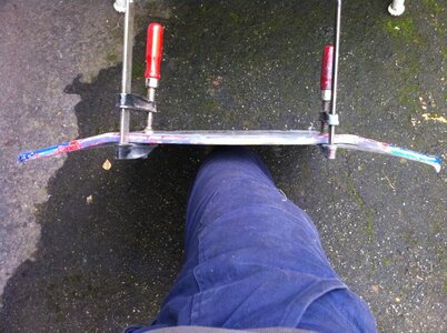

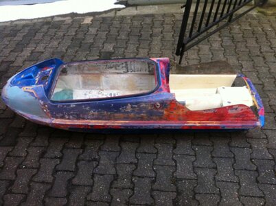

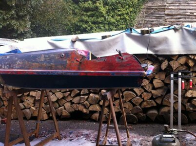

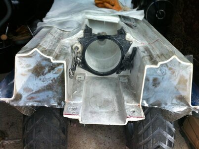

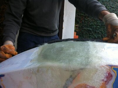

Some more work done

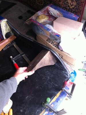

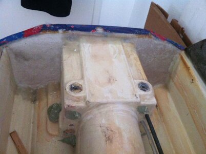

I grind down the Rocker from the outside, and fill the Area with some gfk layers. I dont
want to use so much filler, cause gfk layers are a way stronger.
Which of the Footholds u like more? I found 2 things here, that i can use. The wooden Piece is a little bit to big, but i wanne do it like this.
In the back, i just do 1 layer cause i want to close it from the inside and laminate 1 finish from the outside.

You want Versiplug and only Versiplug.... Versiplug, Versiplug.... Skuppers leak
Your doing an incredible job keep it up!!!
Shorting the pole is a very very good idea, Also chopping your hood might not be a bad idea

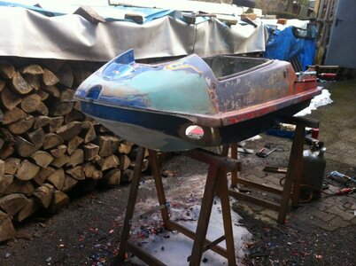

more done

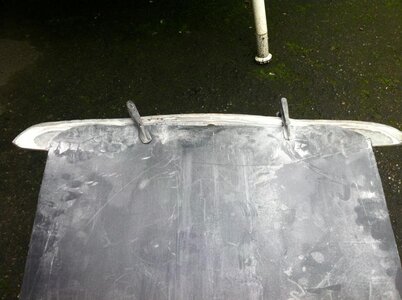

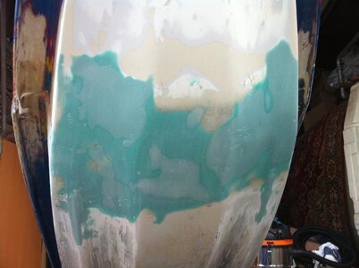

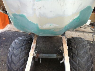

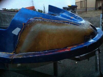

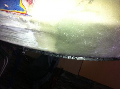

I did some work

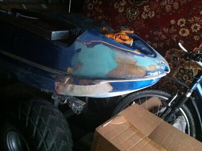

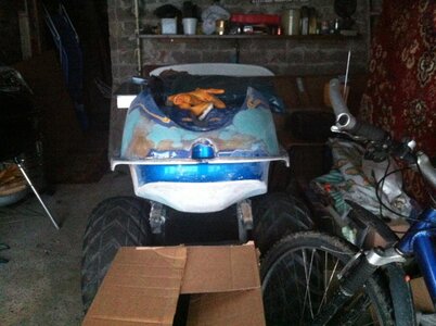

Just grind the Bot and get some Filler on. Now its n!ce and 80 % ok. Its an Mixture of Gfk and fine Filler 2/3 to 1/3. Now i need finish filler.
After that i work on the Front, i make it really strong, so i dont need much filler to make it smooth.

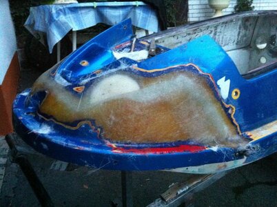

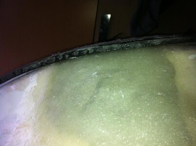

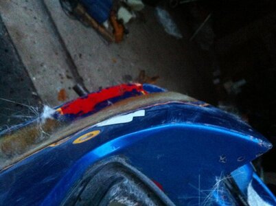

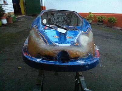

Did some work today. Old paint is hard to get off. Still need some grinding to reach the Gel Coat.
Iam going to close all holes today and work on the back. Iam still not sure about the nose. looking from the front, it looks good, but looking from side, i dont like it.
Andy ideas?

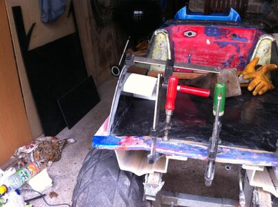

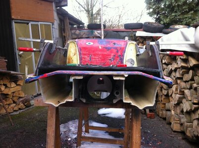

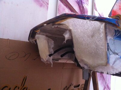

Did some work in the back. 2 Layers from the inside, just to get a form. Next step ist to get the final form, and get it strong in the back.

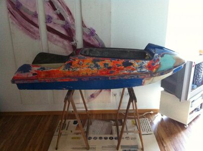

NewName RN (rocker, short, new tray)
Grinding grinding grinding
