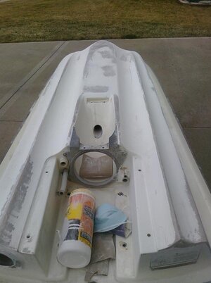

More work done, finally.
I finished filling the tray area with a couple sealed plastic juice bottles and poly foam. I put my cut out pieces back into the tray by adding just a few aluminum pieces glued and riveted to the tray for support and alignment around the edges of the cuts. I then riveted my cut pieces to those small straps of aluminum.
attachment.php
I then mixed up some Phelonic Microballoons (US COMPOSITES) with some resin and hardner to fill the gaps from my cutoff wheel. I mudded all the cuts in really well, pressing the mixture into the gap to fill the void. Mixed it up to peanut butter consistency.
attachment.php
I still have a ton of sanding and glassing in my future, I need to get this thing ready for paint.

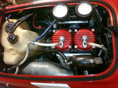

Got all my parts in today. Cracked the lower end open to replace the crank seals.... bad crank. Inner bearings and outer bearings were shot. I will probably send it to crankworks for a rebuild. Anyone use anybody else?
Ok this keeps geting worse.......
BAD CRANK..... probably going SBT
now I looked at all the motor mounts and they all need to be replaced. Anyone have any Octane motor mounts???

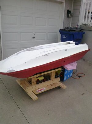

More done. Sanded top and bottom deck. Getting all the scratches out of a former surf boat's bottom deck isn't fun. Knocked out the majority with some higher 150 grit. I have some deeper scratches and other areas that need some filler, I will finish those then be ready for paint.
