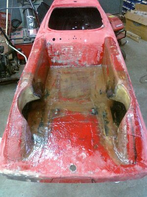

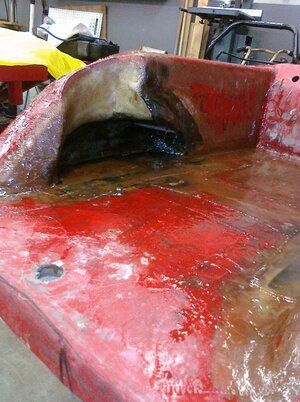

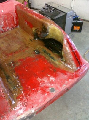

sorry guys it took me so long to get the pictures out to you i have a digital camera but seem to cant find it. my phone took a crap with most of the pictures on it, i just got a new phone a couple of days ago and took these pictures. i got a 25mm and an 8mm plush under matting, and a new sheet of hydro turf i will be working on this weekend so ill get more pictures out. let me know what you think?
peanut butter filler sanded down
wet fiberglass.
dry fiberglass ready to sand.

no i have been email back and forth with Dan from Highroller Customs, he suggested to do the water bottle way. since i only ride in lakes and am no where near the coast, that the Octane hull is strong enough to handle it. i ended up putting in a XFT scupper valve, i kept the drain plugs that i installed from Watcons a couple of years ago. i ended up resealing everything in the back and taking the exhaust out and re riveting it and sealing it. i cutting 2 holes in each side of the firewall so i am able to have all the water flow back and exit out the scupper valve. i also have the automatic bilge pump to help.

i ended up putting as many as i could i had to put a vise on the tray to set it down so the tray was flush. i also put as many bottles in the gun whales. the bottles have no way to move.

it should hold up if you repack it with foam when you are done. also make sure you put thick layers of fiberglass down. i put 4 layers of fiberglass down on mine, but i dont do any surf riding.
I got about 2 layers laid down in my tray now. I don't know how much more to do because I am pouring in 2 part foam in the gunwhales and to fill in voids under my tray. The filler I used (Microballoons and polyester resin) seems really strong.
I will be pouring foam tonight then filling in some deep scratches on the bottom. Almost ready for paint.
FlightRisk make sure you dont add to much foam because it might not dry correctly. and will need to expand somewhere. i have heard of adding to much foam and possibly starting to crack hull where it was patched.
Foaming sucks. That stuff is sticky and expands REALLY rapidly. I think we used just enough. I could feel heat from the chemical reaction all the way up the gunwhales...
For some reason my glassing was'nt quite cured... I'm not sure if we mixed enough hardner with the resin. I will put on at least one more 'hot' layer before being done. Pics soon.
Today I reworked the Wamiltons footholds. I don't have a lot of lateral movement in my feet so I need a way to be able to get into the footholds easier. I cut the tops of the rail and shaped the foam we poured in yesterday. Turned out really well!
THANKS 58VWRAGTOP!
We glassed in 2 layers on the footholds and 1 more layer in the tray. One more layer to go....

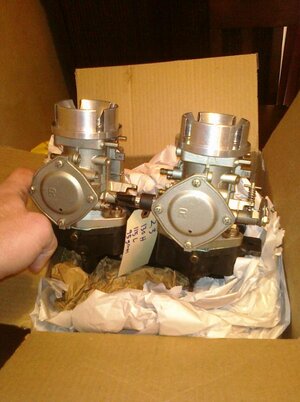

Also a pic of the new carb setup.
