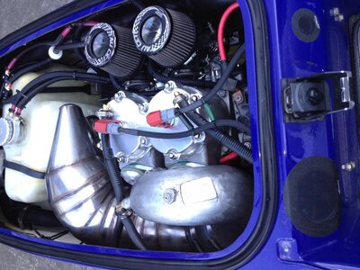

First of all , in the shorft time I rode it yesterday I could tell right away it makes good power .
I have to work on something to keep the chamber from popping out of the headpipe . It never made it more thnan one minute before it popped out . One of the rfeasons the Bpipe is so reliable is because the chamber is wedged in between waterbox and headpipe .
If the stinger outlet was rotated a few degrees forward , the stock superjet exhaust hose could be used . Understanding this is a Blaster pipe , not a superjet pipe so it is what it is .
I used the stock hose and spliced in a section of tube so it would reach . I am thinking the reason chamber popped out is because this hose is pulling on chamber . It needs to be supported off floor of hull and chamber needs to be tied back to motor .
Thaere is no way I would take this into the surf until it is bullet proof . It could stand to have a couple of springs from chamber to manifold etc .
Chamber barely clears stock tank . It clears it but no room to spare . Planned on doing tach test with pet 2100 and putting GPS on it , but due to chamber popping out did not . Last Sunday this ski did 62mph with Bpipe , LTD chamber with Xscream stinger mod .
It is Judge ported 8MM cast Dasa 7 port 862 with massive case porting . in an 09 hull with 140 mag 14 vein setback , novi 48s on dasa intake etc .
Will get pipe secured today and go back out on the water .
Chamber stayed together today. Ran a heavy zip tie round tinged back o an eyelet bolted to flywheel cover. Also put a block of glued turf below outlet hose to keep it from pulling on chamber. Not that I didn't expect it to , but pipe works well. Pulls hard and revs . To rough for tach testing but old tell it was reign higher. Crank wrecking rpms are not what I'm looking for , just good power and this seems to do it .

I have an original tnt SS chamber on my wife's square nose. It's necissary to run these chambers hot or they are no imprvement over a FP chamber. Thats the reason that Tim had the temp sensing water injection at one time. I made a new rubber isolated mount that allows you to rotate it further down toward the fly wheel cover than the standard mount and it fits in a superjet much nicer. It's a great wet pipe chamber...dry pipe replacement it's not.
It fits very nicely in the 08 + SJ hull. I could see where pipe may hit hull on old style hull. Newer hull is wider below bond line. This pipe makes plenty of RPMs. No need for dry pipe. This ski is running close to 65mph. Plenty fast for a standup

This pipe is awesome. Gonna have to go up some more on prop pitch. Snaps out of the hole hard with strong power all the way to 7550 RPMs. Hit 64mph with a skat swirl. Gonna stick the big hub concord in it and see what it does. In the past it was a couple mph faster than a swirl. Never had a superjet going this fast , and it still has incredible low end . Fun as hell to shred water with. This is the Ski Jeff Jacobs wished he had back in the day.
