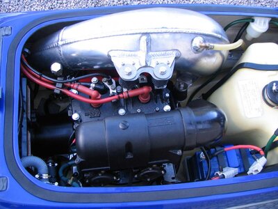

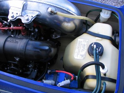

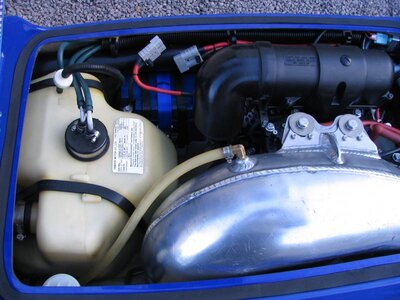

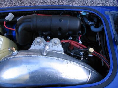

I'd say raw aluminium. Here are a few more pics of my old pipe. It's a (supposedly) special type 4, larger volume chamber made by FP. I used a Riva manifold. That pipe made great power, actually the only problem with is was the light switch power distribution when it kicked in.

Thanks for posting Sospikey!
That one looks like it has a raw alum finish or is that the silver powder coat? Looks like raw aluminum. Is there any difference between that one and the dark blue metallic one that I have? They sure do look the same...
The Silver on the Add, is not, is not the same as the Blue Type 4 that came from fpp

If you check my pics above I ran out of tab. I made a new, larger tab that I attached to the old one. Worked great!

My son ran one on his 650 sn and it was a HUGE improvement over stock. Definitely required some rejetting, but ran very good. Mounted up solid and lined up fine. If the pics are accurate it's the Riva Freeride pipe. It served him very well for flatwater freestyle stuff, and it got BEAT on as far as landings are concerned. But all mounts and cyl held up just fine.. It's going to be in the for sale section very shortly.
