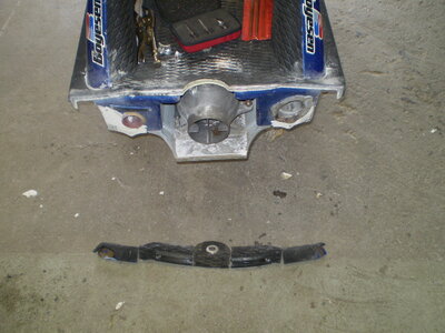

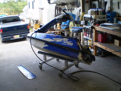

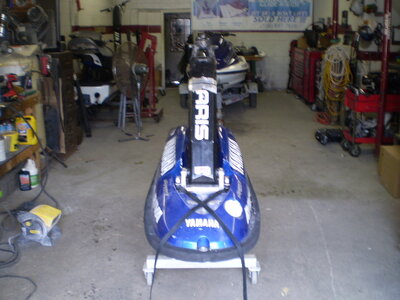

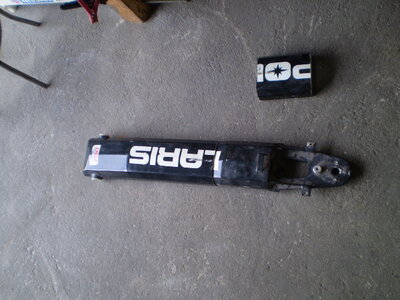

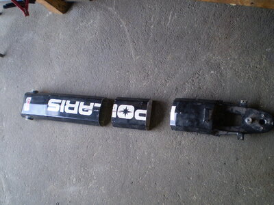

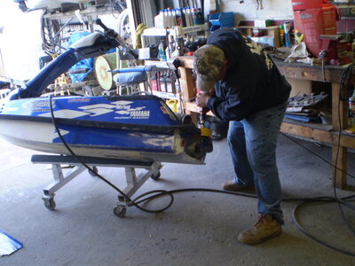

trying to set up a ski to do a back flip. 1 week to get it done. parts that are laying aound.
-7 on the pole
cut the rear lip off
stock port 701 single 46 wetjet carb and intake.
ada head 200 psi (oh ya blown this one up)
wammer trim set up.

Why couldn't this ski be used to do a flip before? :dunno:
You sure that pole is short enough? :biggrin:

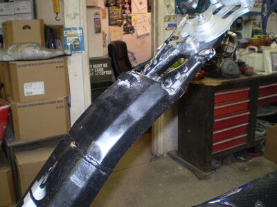

Wow that pole is going to hurt your back if you ride for any extended length of time. Also cutting the lip barely has any effect on how the ski rides in the water. Sure it has less drag but cutting the chines is what really creates the nose high condition that I would think you're looking for.

I second the pole comments. That things gonna suck in the surf. Mine's a little over -5 and it's fine for flatwater but in the surf I could definately go for another couple of inches.

I am running a -2 pole and -2.5 xmetal steering setup. i will be cutting 2 more inches off the pole this winter. it still feels long in the surf at -4.5

the plate is going or getting cut. this is an in progress ski. i have all the parts kicking around never did a full blown surf only boat. my normal sj is more of a cc boat that i jump waves with. i cant give up the handling. this boat is an x race boat i got cheap and wanted to make it as easy as possable to try and backflip. this is a team effort to try and get one of the crew to do a backflip. i figure 1 of us has to get it done. then the rest of us can figure out how to do it also. (and grow a set lol)

my sn is now a no nose . its ugly but it still works. it just cant take another shot like it did. it looks like the learning curve for a back flip may cost me a hull at some point.this ski is that hull. (i hope not but it is what it is) like i said this is a here you try it boat.
baldwin ny

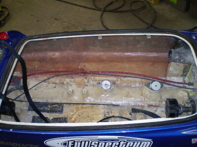

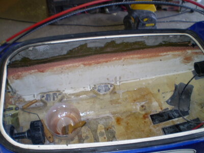

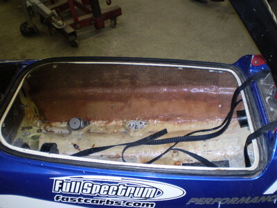

only got to it today for a few hours. the cut on the the pole is a -7 from stock octane. works out to a -4 for a superjet.i have a umi turn plate on it for now. mite go another -2 with the turn plate. 4 new motor mounts. still have to pull the jet pump and see whats in it.
0 tubbies on . some glass work for the sides just incase. lol i need to do the nose bu tit can wait. (starting to get cold and running out of time to ride.)
