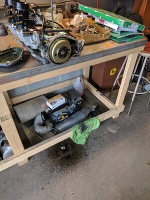

Deto on front piston. Looks like crank seal failed. Odd bc they were brand new oem seals.. maybe 5 hours on it.
