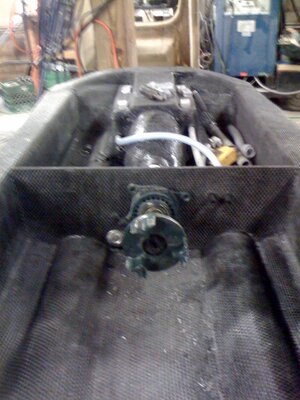

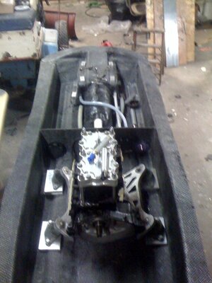

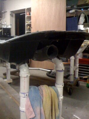

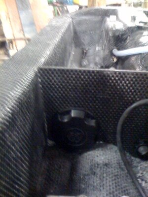

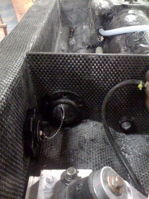

we decided to build another new hull. this one buy far will be the best one. we made it a good bit shorter and a hair wider. there are a couple other mods we did to it like moving the pole forward and changing the pitch of the nose. the best part of the new hull is that it will use a superjet hood. so you can use you old hoods and still have that nice size opening into the engine compartment to work on it unlike some other hull that have a smaller opening. we just layed up the first two bottom decks and once trimed they weighed 14.5lb and beause of the new carbon core materials used to lay up these hulls there will be no need for any reinforcements. so we are estimating the hulls will weigh around 45lb to 50lb
