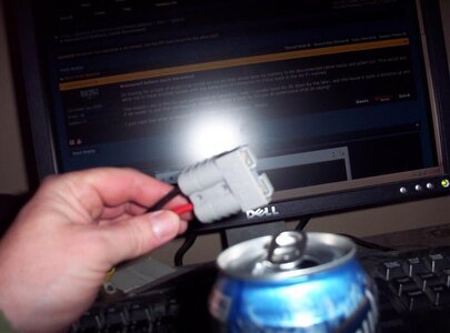

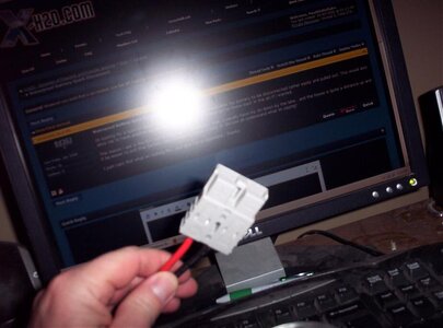

I like to use these, off of UPS battery packs.
they are available online too, larger versions are used for forklift battery packs.
