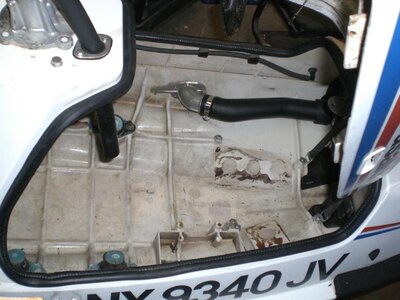

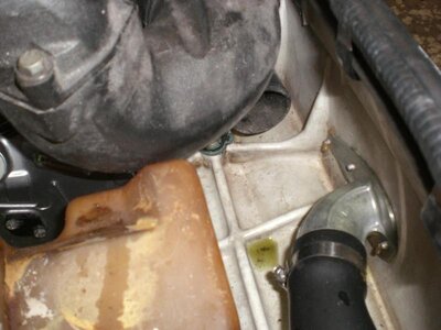

cleaned the hull up inside some. replaced the mounts (had used ones) drive shaft bearing is shot (its kawe) got a new one. forgot the stock sxr pipe at work. going to cut the left side foot tray out to do rear exhaust. mite do a pump dump or possable out the side. was thinking about a scupper on the right side to help with the water issue x2's are known for. any one do one? i see how to mod the hood to help keep the water out.(at least the way i think will help)more to come on this one lol. trying to get this done before the water is frozen.

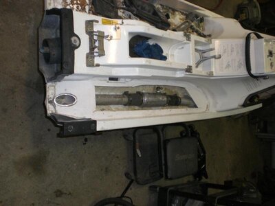

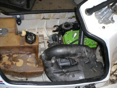

droped the 750 in for a mock up with the stock sxr exhaust. good news is it will fit.bad news is there some glass work envolved. the stock x2 exhaust outlet is in the way. i was thinking about cutting the right side foot tray open .put a westcoast silencer in there and foam it in.run the rubber hose infront of the motor across the hull and out the right rear. exit the exhaust into the pump area.or out the side.
going to lose the dule carbs go with a single 46.stock 750 sx ele box.

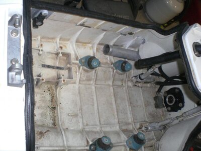

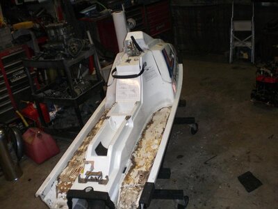

made a mess today. lol i hate defoaming. i will weld the 2 pipe together.still have to figure out an exhaust outlet in the rear.i was going to square off the back of the ski but i changed my mind. i am going put it through on an angle.hull was bone dry inside. water box up front is going this will give me way more room for a fuel tank and the 750 ele box,batt.

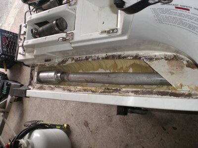

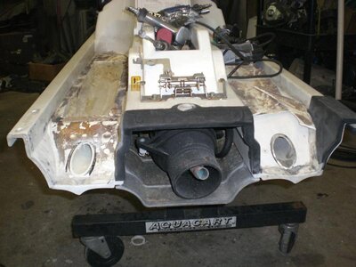

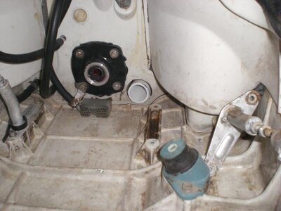

its in there. tubes are tacked then the hoses are on. going to foam it all in. next its the scupper on the other side. going to try and get it all the way in the back next to the drive shaft bearing housing.

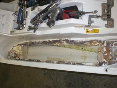

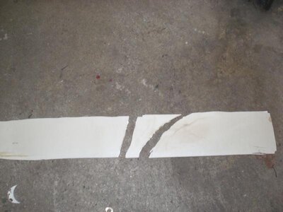

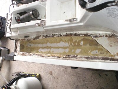

thanks . i worked some more tonight. wasnt plaining on cutting the left side tray out but found that its full of water. the top of the tray was cracked in 2 spots. oh well made it easy to do the drain valve.its just mocked up now. i have to get some six-10 and glue it in. install the tray and refoam it all.
