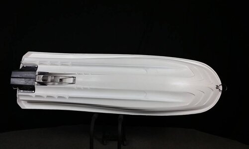

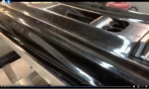

If you look at any aftermarket racing hull (prowatercraft, Kommander, Bullet, etc) they all have very loooong narrow pump tunnels, gradual transition from the bottom of the hull and the pump is moved back closer to the back of the hull. If you look at the progression from the sx650 to sx750, sxi, sxi pro, sxr, the pump tunnel got progressively longer, and the pump itself got progressively moved back toward the back of the hull. Pump tunnel never got wider, or at least not more than a few mm. Superjet in 08 rear of hull got narrower, pump got moved backward, in this case the tunnel didn't get any longer but it was moved back with the pump and the top of the tunnel got much more square.
Couch tunnels tend to be long and swoopy, not super wide (although some of them are kinda wide because they use such huge pumps).
I think the reason they don't go wider is because as you provide a theoretical smoother flow of water in on the lower side as the ski leans, you are also exposing the upper side to the air so it can loose suction and let go.
I also think that is part of why they move the pump backwards, keeps the pump in the water becuase the ski rides lower in the rear.
My $.02. If I was looking for corner carving I would go long and swoopy, not wider.
