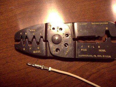

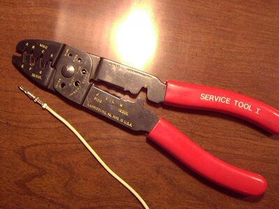

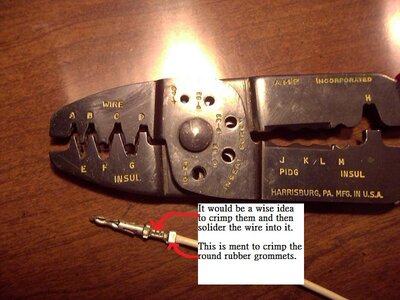

This is your "normal " crimper. Made right in your neck of the woods. Put lots of grease on the connections and terminals before you install them. I use the same grease I put in trailer bearings, there is just no need for dielectric (non conductive) grease in this application. - You might find a similar Chinese made crimper at your local Lowes or Home Depot.
