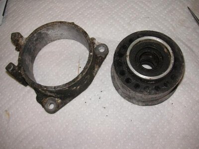

Midshaft housings are made from an aluminum outer housing which is separated from the aluminum inner bearing core housing by rubber. The inner and outer housings are vulcanized to the rubber. The rubber acts as a dampener which allows the inner bearing core to flex with driveline movement.
The rubber of the SN housing is relatively thin, and can tear and separate just from vibration. The larger redesigned 701 housing has a much thicker rubber area, and separation of the rubber from aluminum generally only occurs from corrosion. The original oem housings around are also increasingly getting dry rotted and cracking due to the age of the rubber.
Housings which separate cannot be rebuilt and must be replaced.

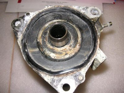

Midshaft housings have a rubber lip on the back to seal the housing to the bulkhead where they are mounted. This seal is easily damaged and can lead to bilge leaks and cavitation issues.
It is important that your midshaft seal well to the bulkhead. We prefer to add a thin bead of silicone just to the outside of the rubber lip as a secondary seal. It is a bit of extra work to remove and reinstall midshaft, but your seal to bulkhead will be assured. Bilge water cannot start corrosion and separation there either if silicone sealed.

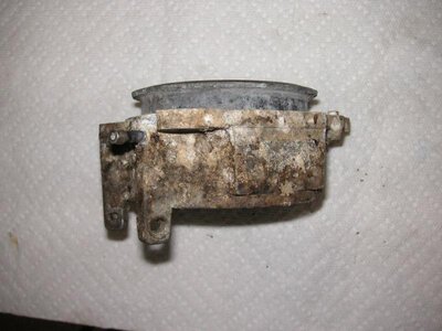

You can see where corrosion is compromising the seal on this salty dog.
Corrosion can also pit the inner ring where the grease seal goes causing leaks there as well.

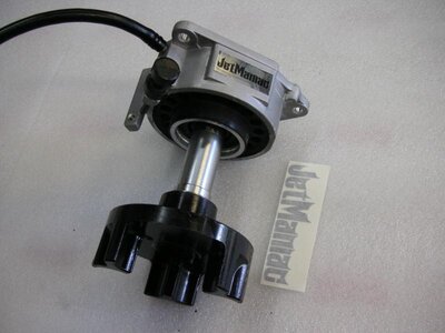

Midshaft housings which are in good condition can be rebuilt to replace the bearing and seals and function like new again.
There is a fitting and hose with a zerk fitting on newer SN housings, and all the larger 701/760 housings. This is used to replace grease which is washed out over time. The grease goes between the 2 rear grease seals only. It doesn't grease the midshaft/driveshaft splines. Caution must be used when adding grease here because excessive grease added will either blow out rear seal or crack the rubber of the housing. Some just use a bolt to seal the housing here, and then add grease manually when the shaft is out of the housing for maintenance. Then you can regrease the front seal and other areas as well.
