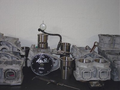

I have dial indicator with a flex arm clamping base that you can purchase at Harbor Freight for 27 bucks that works great for checking the port timing while the head is removed. It could be clamped onto one of the girdled head bolts and used threw the spark plug hole to find TDC also.

Yep... those spark plug hole dial indicator TDC tools work great.
The timing tapes are in the works so it shouldn't be too much longer before they're available.
