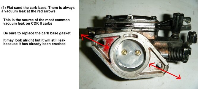

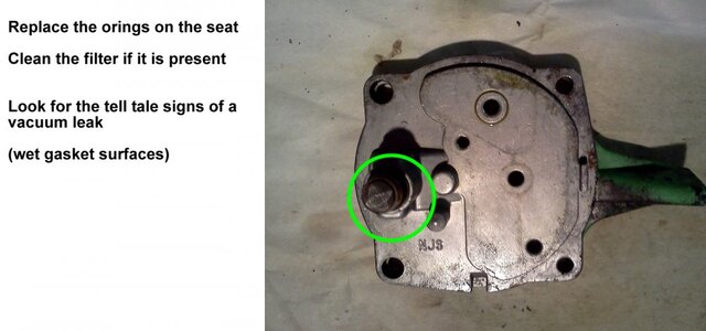

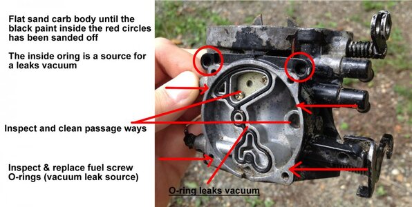

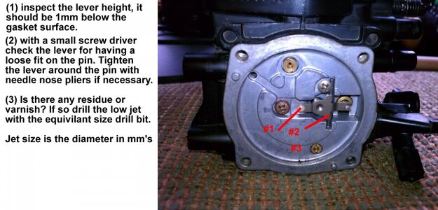

Below is a tutorial for rebuilding Keihin carbs
Remember your needle and seat isn't opening. That is why it only runs when
primed. That is a common problem and you need to fix the vacuum leaks
that cause the problem.

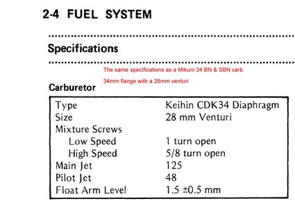

Your correct, Group K, Hot Products WSM, are all wrong because they call it a Keihin 28mm for the 1986-1990 650, it's not "my logic". And yes, I owned a 1989 650SX for many years with the little remote pump Keihin. It has been known commonly as the 28mm since it was introduced in the 80's regardless of what the actual throat diameter is.
This is how it got started, look at my attachment from the early X2 manual.
it clearly lists the carb as a CDK34, but for some reason Kawasaki listed the
venturi diameter as the size. I have always measured at the flange or spigot
of all motorcycle and watercraft carbs. It is close enough.
Look at picture #1 it demonstrates why vacuum leaks are so prevalent on
Keihin carbs.
