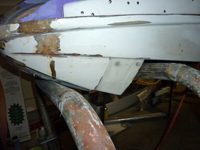

get rid of the nose and strip some stickers

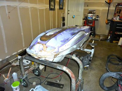

OK this a couple weekends ago I had a chance to start digging into the ski. This FX1 has seen it's fair share of riding so it does have some battle scares. The black piece on the nose is some multi-colored carbon fiber that was capped on there for reinforcement. Structurally it was probably fine but it really didn't look good, lots of excess epoxy and lumpy, plus not knowing the history I did not know what was going on underneath. So with a sander, heat gun, paint scraper and a rubber mallot I was determined to pry that carbon fiber piece from the original body underneath. Took about 1.5 hours but it finally gave way and I was able to chip every last bit off from there. Looks like there was a puncture at some point in it's life on the nose that was patched with some glass matt or heavy chopped strand. So I'll have some filling to do here later when the rest of the body is ready for that stage as well.
I also started stripping all the old stickers off which was another hours of fun. Slow and steady I know I have a long ways to go.

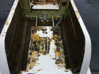

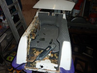

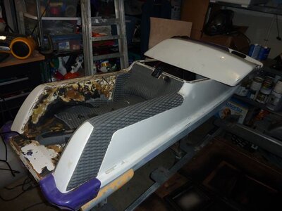

Ok last week I posted a question to see if others thought I might have some wet foam based off the weight of the hull. So she weighed in at 115lbs with the hull, turf, and hood. Everything else has been stripped. The general consensus was that I might be about 10-15lbs overweight.
Uhhggggggg. So there goes my wonderful footholds and turf that were still good on the ski. So I took about 15 minutes each morning before work and stripped off a little turf. It did not come up that easy but with the help of one of those oscillating tools I was able to get most of the turf up by the weekend.

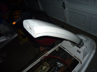

shorten it up

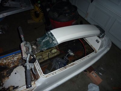

As soon as the mats were off I was staring at that darn handle pole and. So I figured since I'm going to totally shock my riding style by using footholds for the first time I might as well throw everything out of whack and shorten my handle pole as well.
Drilled out all the rivets on the top and bottom bracket. I was thinking I could just heat up the fiberglass and metal with a heat gun and it would wiggle loose. Ummmm no luck. So I took out my hack saw and lopped the top bracket off right where the fiberglass meets the metal. -1.5" approximately gone. Cracked out the old fiberglass in the bracket. Took a wire wheel to the inside of the bracket and sanded the pole a little bit to check the fit. Mounted it back on the ski and wow it really puts your body forward which I guess I'm going to have to get use to if I'm going to commit to changing my style.
Anyone have a good idea for getting that bottom bracket to release the pole? I'd like to free it up so I can sand and paint the metal.

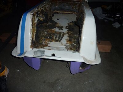

Defoam holiday

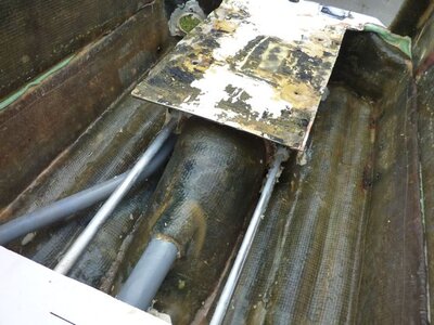

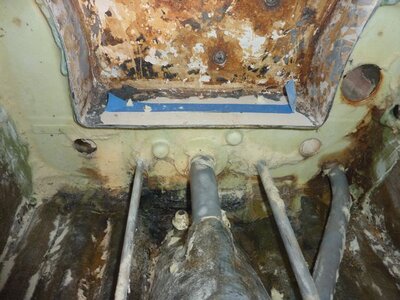

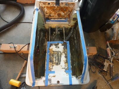

What a treat I had President's Day off so with the wife unfortunately having to work, I had a full day set out to tackle my foam issue. So I read a bunch of threads last night on defoaming and what to fill it back up with and where to cut..... yada.... yada.. yada...

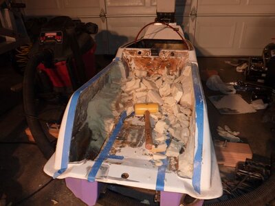

9:30am I took the oscillating cutter tool, taped off where I wanted to cut and made the plunge.
My goal was to rip the gunwales down to be about half the width to widen the tray a little bit.
Not sure if it is my cheap harbor freight blades or what but the saw didn't handle the fiberglass like butter, so I switched to bimetal blade on my jig saw and made all my cuts. Had to use a dremel and a cutting wheel in a few tight spots. With all the cuts made I started prying, jamming in screwdrivers, putty knives and whatever else I could find to break the foam loose. I ended up making a few more cuts to break the pieces up into a left, right and a square over the pump. This seemed to work out perfect and with a couple good wedges and a big leveraged wrench I was able to break the sides loose.
Now on to the fun part. Trying to get the foam out. I used the oscillating tool with a knife blade and made some small cuts and started to just chip away at it in small chunks. Then I thought I'd try a cup wire brush that many recommended. This blended the foam into dust pretty good. I only wished I had a plug in drill, cause my makita was getting a workout and the two batteries couldnt keep up.
After about 3hrs I was down to just the little nooks where the wire brush couldn't reach. Man I think I saw a thread that said someone defoamed in an hour.... not even close and I was hard at it. I realized I also needed to take my exhaust out to get better access and would need this removed in the future anyway if I want to reinforce the sides a little bit.
So with as much as I could get out I carried the hull out to the front yard and power washed the inside to get rid of the last little bits. It was about 6 hours from first fiberglass cut to a completely defoamed but I feel better and can start planning forward progress.
I plan on putting close cell foam in the bottom a few layers high and then 2lb or 4lb expansion foam on the top from just below the tray level on up. Will add drain plugs in the back to hopefully let out the water in the future.
The ski with hood now weighs in at 89lbs.

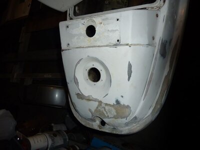

Hey what are the 2 circles plugs on the firewall on either side near the bottom? why are they so thin? One was already busted through and i ruptured the second one with the power washer. I should just glass these in right?

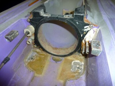

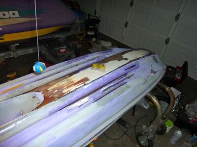

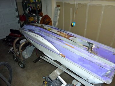

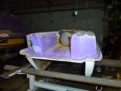

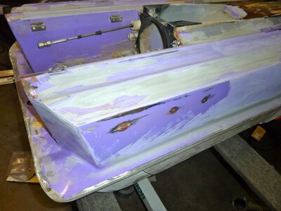

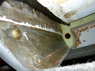

The combination of not having a lot of time and this stage of the build being a slow process for me, progress has been reduced to a crawl. I can already see I will be at this stage for another couple weeks in order to get everything installed and filled in. With that said updates have been:
Drilled and installed 3/8 drain plugs. I used stainless T-nuts and epoxied them in. The plug is a stainless socket, allen head machine screw with an o-ring on it to seal it up.
Filling in various scrapes and holes around the hull.
Filling in High Pivot Handle mount area.
5200 bond line on gunwales. Will glass over this area a little later.
Right Side Tubby installed
Epoxied 1/2 aluminum rod on the underside of hood lip for strength.
