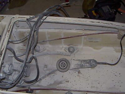

My budget freestyle build (updated)
This is the project I have been working on this winter. I bought this squarenose at the begining of last summer.After the season was over I decided to tear into it. Im having to be a little conservative because we are trying to save up for my wife a new ski. Im staying with a 6m6 for now but building a motor over the summer. Here is what its going to have.
  • protec ported 6m6 with 701 bore
  • 175 psi shaved stock head
  • boysen dual stage reeds
  • coffmans sizzler pipe
  • solas impeller ? pitch
  • wetwolf freestyle cone
  • msd enhancer
  • oceanpro open ocean ride plate
  • Riva triloader intake
  • Umi steering 4deg bars
  • wamiltons cyclone footholds
  • Reinforcing hull
  • hood mod
  • diamond hydroturf
  • turfing the rails
I have been ordering all my parts and finally have everything but some little odds and ends. Ill post some pics as soon as I can figure out how to do it and it not side scroll
