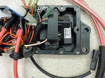

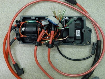

JetManiac just received our reorder shipment with the new Zeel design.
It looks very nice. Box is smaller and now potted with a rubber plug over programming port.
Great update for helping to prevent issues, if ebox gets wet, especially in saltwater. Also a programming change was made so the lump does not need to be removed from the flywheel.
augustaf
And for the 760 purists and those who can afford a 760 box: it fits well, might possibly pad it a little to keep from moving around a bit (like in rattling) which might be hard on the ribbon cable.P1040073.JPGP1040074.JPG

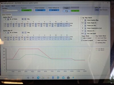

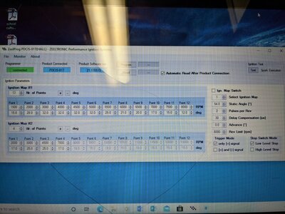

Can someone double check this curve on a pdcis01t? Specifically the static angle. I am trouble shooting this unit for a buddy. He says it's backfiring. 3rd lobe is ground off.
