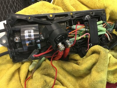

Over a month ago ski at times wouldn’t start so I changed the starter again the ski won’t start so I opened the E-Box and saw salt water and large salt deposits cleaned everything out and changed solenoid still nothing what’s left
Solenoid clicks and when you hold it you can feel it clicking

try earth cable, and battery leads , connection to starter
earth lead can be discounted by using a jump lead from battery to motor

What happens when you jump/bridge the starter relay studs with a screwdriver?

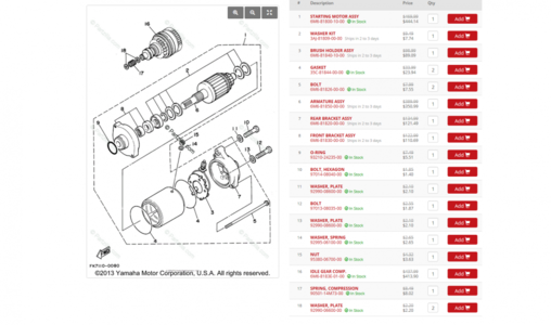

@JetManiac must have new oem starters? Or know of a good quality rebuild. Also what about jetskisolutions.com ?
https://www.partzilla.com/catalog/yamaha/waverunner/1995/fx-1-fx700t/starting-motor

The bendix is under the flywheel and flywheel cover, it is not part of the starter. They are separate components.
What is the voltage across the starter when you press start and you hear the click?
If 12V then swap starter. If less than 12 (0?) then figure out why.
Jet maniac said bypass solenoid I just went to my local dealer and put a new one in I honestly tried the screw driver across the terminals of the solenoid and it sparked I gave up on that idea don’t want to blow anything so new one in.

Have you done any voltage drops? Doesn't matter if it's a new solenoid, it can still be bad. Voltage drop all components. That will tell you where the issue is. Jump the solenoid is the easiest tell tale, you won't blow anything up.
