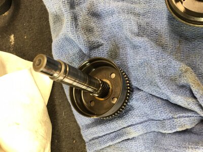

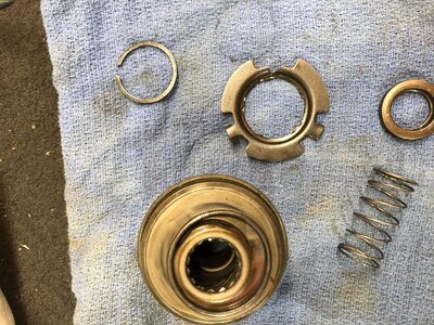

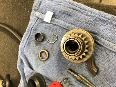

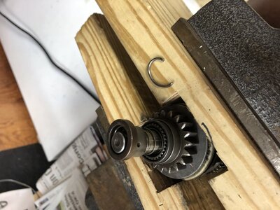

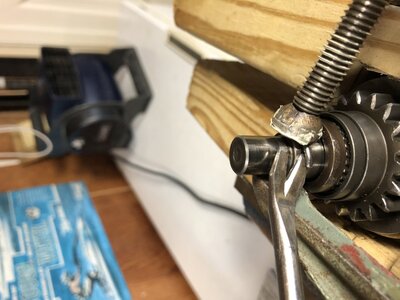

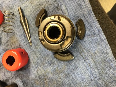

Had some time this morning to take the bendix apart.l can see how one can stab yourself with a aharp object trying to take apart,as @iQRTurbo said in his post.
l figured there has to be a different way.l already had some 2x4’s that had a notch cut out in them,so l set the bendix down in between them,being careful not clamp down on anything that would bend (mostly on the large gear at the bottom was where the pressure was).l slid the retractable collar down and got a small C clamp around the shaft and c clip,making sure not to tighten it down “too” much.Now both the bendix and clip were both were not moving.l used a small panel puller and hammer to get under the clip,using the angle of the panel puller to wedge it out.Boom! it worked and no self mutilation of fingers.
From there,it was a matter of disassembly as you can see from the pics.l could not find my snap ring pliers and had to order some new ones,which should be here today.
To be continued..

l got the snap ring pliers in and got the weight spacer plate off.Now just waiting on a new one.l wanted to get a spring too,but on back order.I’ve been told you don’t have to replace it,but since you have the bendix apart,why not.
