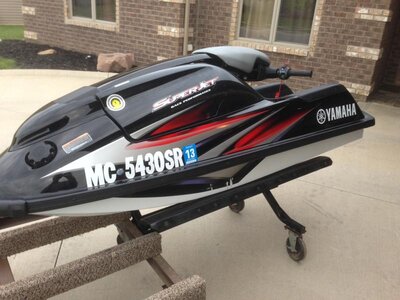

Iv had alot of stand ups and have a heavily modded 01 RN SJ and a stock 04 RN SJ and just rode the 04 stocker for the first time and was really impressed with the power it had! I'm starting to wonder if the headache of aftermarket parts are really worth it...I think maybe milling the stock head and adding an impeller wouldn't be far off a pipe SJ really...just my 2 sence...iv never rode a stock SJ before and was really impressed

Would be verry :):):):)ty if i had just spend my money on a MSD, B-pipe, intake, impellor e.c. e.c and it would not be better then stock haha.
With the upgrades it would have 100 HP.. always better then the stock 70 :)

The only thing that situation says to me is that your '01 modded SJ was either broken or horribly tuned.
I have a 2004 SJ. Stock it cavitated continuously. With the intake and prop, the cavitation stopped, but it handled like crap. With the destroyers, Dominator ride plate and rear sponsons, it handled pretty great but it had no hit, wasn't that fast, and took a fair amount of time to get going, it sucked in the surf with no giddy-up (even when I took off the longer ride plate and rear sponsons. Had the T-screws in the carbs and it was dialed in pretty good (until the :):):):)ty SBT rebuild kits started leaking, buy genuine mikuni!)
I just tore it all down, put on MSD enhancer, #ZERO lightweight flywheel, ADA girlded head 180 PSI, B-pipe limited (damaged head pipe, top 2 screws closed, bottom wide open), jetworks flow control, dual stage reeds, reed stuffers, stock airbox -1 screen, properly jetted, -3 pole, Cold fusion throttle with oversized cable...
I just started tuning it. It still has a bog in the bottom and I'm afraid to run it wide open because I need more testing (Ran it wide open about 1/8 mile and plugs were a nice brown color). A lot more tuning is necessary to get it perfect and I can't even tune the pipe.
My ski has WAY more snap off the bottom and that's easing into it because the bottom is still a tad lean and my popoff is 53 (kept stock pop-off). I haven't GPS'ed it but I'm sure it's at least 5mph. Speed is kind of irrelevant, except I have it propped to be good all-around. It gets to 45mph in far less time than it did before. It feels 100 lbs lighted coming off the wake because when I squeeze the throttle, a whole lot more happens. Long story short, poorly tuned, it rips compared to stock.
I'm not bragging about how awesome my ski is, because it is just set up as an every-day limited class ski set up for all around riding, so it's not great for the surf or racing, but good enough for both.
My point is, if you can compared your "Heavily modified '01" to your "all stock '04", then you '01 wasn't "heavily modified", it just had a bunch of expensive parts slapped on it doing a whole lot of nothing.

I haven't even rode my 01 yet,I had a 98 with dry pipe,msd, prop...yes it was a little faster but I'm saying the problems modded skis vs stock I'm starting to wonder if it's worth it... My 01 should rip big time,I'm just saying my stock 04 has alot more bite than I thought it would...iv had several modded Kawi and this stock SJ is far btr...
I can't ride stock skis anymore. I have a bpipe, ada head, worx grate, mag pump, hooker9/15, and h2o designs water box. It is a huge difference from stock. Stock skis feel like a dog. Riding a kawi feels even worse

Was your 01 SJ set up properly? Or as Vumad said, someone just slapped all the parts on and didn't take the time to tune it all in.
I thought my stock SN SJ was a blast with just a Red Pipe and a prop. Then had my buddy port the engine, rerun the water lines, and bore the nozzle. It was night and day difference! I will never own another stock ski in my life!
