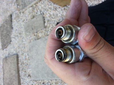

Cleaned the carb at the beginning of this year. Little bit of gunk but not bad at the time. The ski has stock jets, pop off is 53 psi and I replaced the large external fuel filter a couple of weeks ago. From my searching around, I thought it could maybe be the spark plug terminals but I am not sure. I took the plugs out after I got home and they looked almost too clean. What do you think? Left is the rear cylinder, right is the front cylinder.

The needles (of the needles & seats in the carburetors) are probably starting to wear and need to be replaced. But yeah, replace the plugs first.
