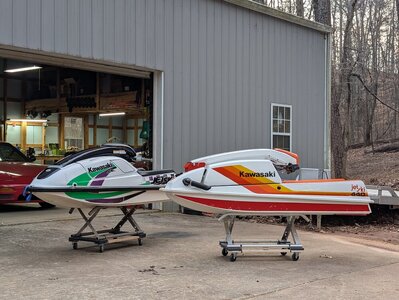

Went on a trip again to visit my good buddy in Alabama!... This time just a double, no car trailer thankfully.
We needed a replacement motor for a friends 550, and a friend (who got cold feet) wanted the sxi pro
So stared at the weather all weekend like a hawk, we got 3 inches of snow here in ATL, and immediately it turned to a slushy mess.
Managed to have some fun though with friends before it all rinsed away.
Seller was in stock at his lake residence where he stores his fun stuff, so wanted to get the job done. Saw a good slot on Saturday where we could get back before temps got too low and everything froze back over.
Made the Journey!
I wasn't going to back out of the SXI PRO after agreeing to purchase it, decided I'll make something of it we know I love a good project. Got all sorts of various parts & engines.... But alas I had a double.. with one empty slot.. So we know what happened.
Obligatory Buc-ee's Picture
Finally All home, ZERO road drama, nobody was out, roads were gross but zero holdups.

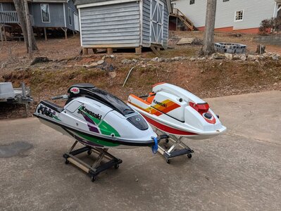

Let's start with a quick detour...

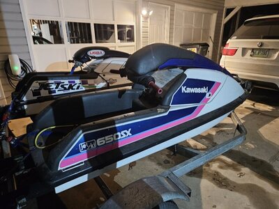

1988 650SX.. It's going to a buddy but we can talk about my short ownership.
I knew it was a good unit, didn't bother trying to run it or anything there, probably hasn't ran in years.
Some liquid encouragement she fired right up!

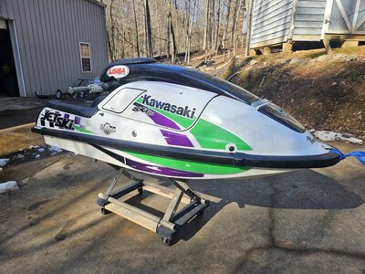

Back to the pro... Got it all cleaned up and out in the sun.
Plan is typical whole refresh.
Some pain points I'm not overly stoked about.

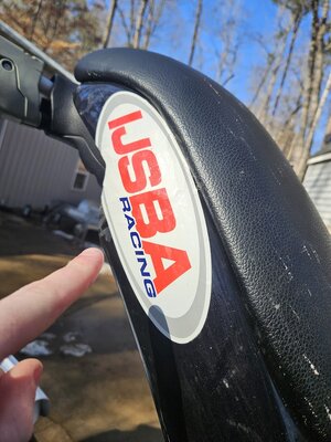

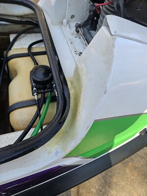

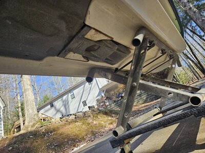

Fiberglass repairs:

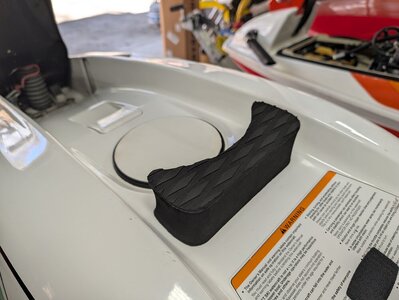

something is DEFINITELY hiding under this sticker
Missing parts:
I have the i-body carbs... yes I know "jUsT rUn tHe foRTY sIx"
I am in need of the manifold and airbox arrangement. missing those pieces... DM me if you have!
Either way should be a fun little project when I have the time!

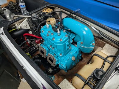

ATL

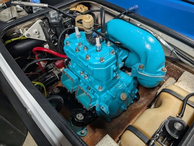

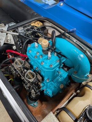

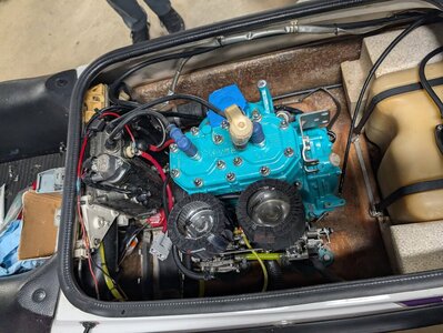

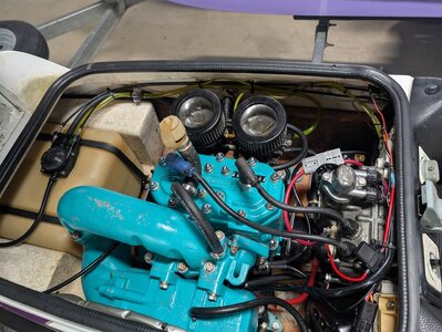

For the first time actually wrenched on this thing. Finally got a twin mikuni 40 manifold apparently on the way. So figured I'd investigate.
Ripped off the intake manifold & the old junk fuel lines.
I realized the Kawasaki Green wasn't exactly right, cause the single carb manifold on it matched perfectly which was odd. So I proceeded to spend the next 30 minutes looking up part numbers to convince myself I actually had an sxipro engine here.

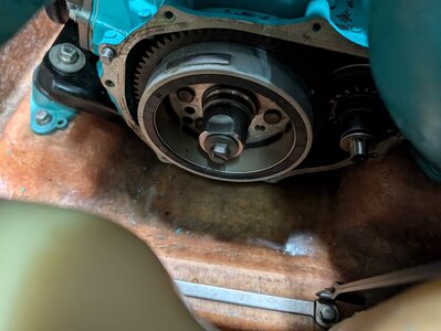

All checked out, guess someone repainted it to clean it up one day, original pistons in there etc. You can see the color difference in the intake ports. D head, cylinder part # ending in 29 which matches the parts diagrams.
I always complain about it but there's something therapeutic about cleaning the studs, chasing the holes and reinstalling all nice and clean.

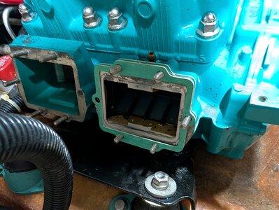

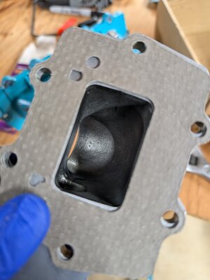

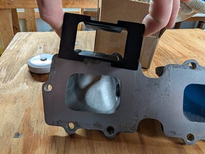

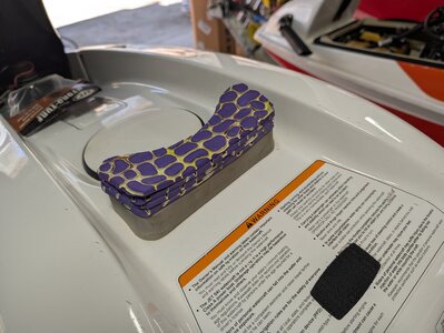

Kinda at a weird stage, I'm not sure I have any belief that the Reed stuffers are helping. Same with the stock MLS outer Reed gaskets. I'm thinking I'm going to run no stuffers and just use 2 inner gaskets, I mean the stuffer & gasket themselves are both smaller than the intake manifold ports. Seems kinda counter intuitive, but what do I know.

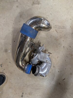

So the next fun curveball. So I have this R&D pipe. Think we will start without it but we got options. Wish I could find some instructions, I know it's a top end pipe, sure I could optimize it to be a bit more fun if I drill it out a bit.
It's mostly fueling very little data about. I was gonna go off the factory pipe instructions for jetting but that just recommends basically stock carbs settings which sounds a bit surreal
More research to be done!

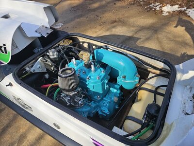

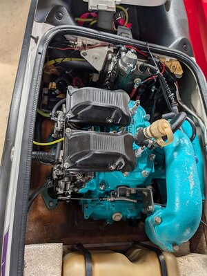

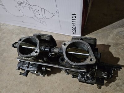

Okay Got the sxr intake manifold... turns out the gaskets and stuffers mate up perfectly. oddly the pins on the manifold to align the carbs are way too long... maybe the sxr carbs are chewed out a bit deeper in the carb body... guess ill just cut them down.

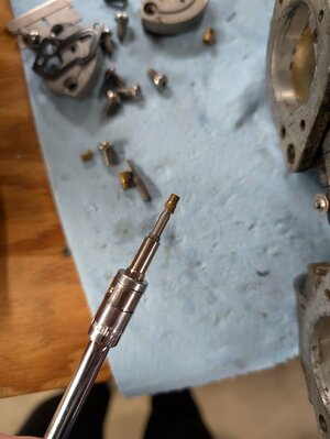

Carbs are also HIDEOUS inside, one jet was NOT fun. oh well.. would love to find a stock airbox but probably a tall order.
SERIOUSLY WHO DOES THIS??? both were like this I couldn't believe it

Make sure the carbs are perfectly clean and do initial runs with the stock pipe. It will be easier to burn a piston with the aftermarket pipe. Also get the bracket that connects the exhaust to the cylinder, It will also have the throttle cable mount built in.

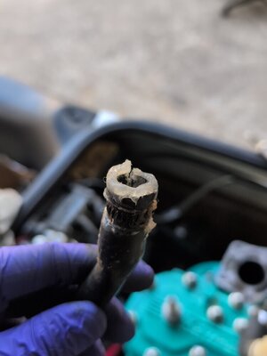

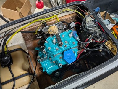

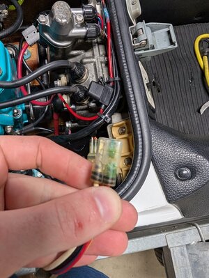

So I've purposely avoided staring at this thing too closely... Then I spotted the main feed line.
So pipe off.... Kinda frustrating I've convinced myself I'm sticking stock pipe for now so annoying buying more gaskets.
Cleaned the tank, ran fuel lines, got the kevbo bracket, rebuilt carbs, mocked up the battery cables and ordered some up.
Prince is running so this is now priority #1

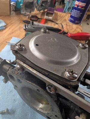

ATL

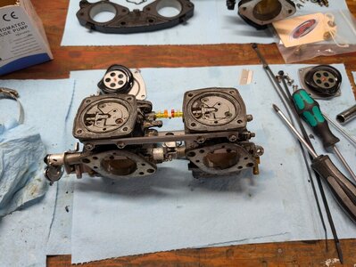

Carbs rebuilt
Went for a sort of tweaked stock specs off of frankly just a little experience at this point.
147.5 H stock
67.5 L stock
1.5 N/S stock
95g springs pop off ~35PSI stock was ~50
HS 1.25 (stock 1 +-0.25)
LS 0.75 (stock 0.5 +-0.25)
I figured without stock air box, I should atleast be at the richer end of the stock spectrum as a starting point. As well slightly lower pop off. Some research on the ole search feature I found 3 things.
1. Dropping Pop off helps a lot in this setup vs stock
2. Increasing to 72.5 or 75 Low jets helps. Factory pipe asks for a 75 low stock 147.5 high interestingly.
3. Epoxy the crossover...DOH
See what she do.

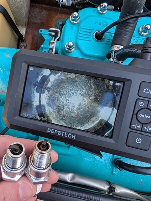

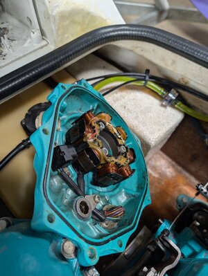

Next checked the stator & flywheel, first look inside for me on this 750. Checking another box. Not a 10/10 but she's atleast an 8.5 in there. Cleaned up the stator magnets with some elec contact cleaner and bolted it back up.

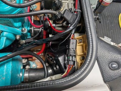

All back together. Redid the rear wire, I wasn't happiest with the wire cap. Unfortunately I've ran out of what I thought was an endless supply of those seadoo caps. Oh well.

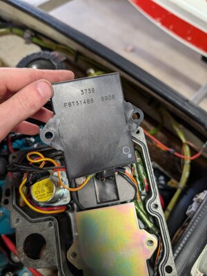

If I find some more time before next attempt to test. I'd like to ohm out the ignition coil itself, I've had issues in the past with just old decayed plug wires.
