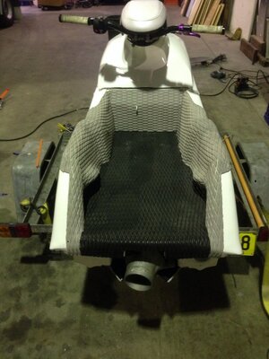

Bar jumper Location Sydney Nov 20, 2014 #6 It's -2.5 photos a bit dark you can kinda see itLove how it rides
