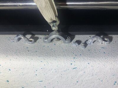

Not sure where else to post this so if it belongs elsewhere please move.
So, I have a 2004 MasterCraft ProStar with a wakeboard tower. The bimini top is mounted on the tower and there are plastic isolators (don’t know what they’re called) between the mounts and tower. Apparently they have disintegrated over the years and can’t source them from MasterCraft or any dealer I called. Curious to see if anyone could 3D print 6 of these if I can remove the only one that is still intact?
Or if anyone knows where I can source these?

Yes you can make working bimini parts with 3D printing.
I do not believe a 3D printed part is the best choice for your application.
I agree with the rubber part.

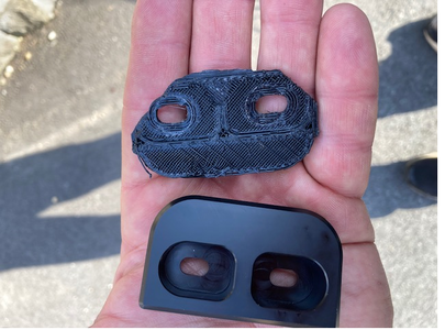

I agree with @Quinc on a 3D printed part not being right for the application. I purchased some 3D printed door bushings for my Miata, the results were far from stellar: (Top one 3D printed result after 3 months of use, lower one is Delrin)3d print.png
The 3D printed one disintegrated down to about 1/64 inch thickness from an original thickness of 3/4" or so...

That a really bad print

The issue is 3d prints have air inside unless some one does a solid fill print Which hardly anyone does. Its never going to have the fatigue strength needed

I think I’m going to call MasterCraft again. I think I just need to talk to the right person. It’s been like this for a few years already and it’s still holding ok. So I have a little time.

I believe those Bimini parts came from Taco Metals. There was also another company that copied that oval design but I don't recall who.

This is the info I was needing. Much appreciated.
