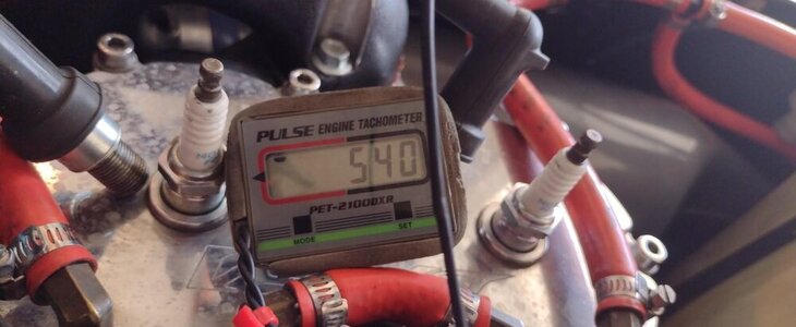

The Max Starter Cranking RPMs (with fresh Battery) from a mint 62T Ignition System/Starter in a Stock Stroke PV 850 Dasa Engine with 180 psi Compression was 540 rpms read on a PET Tachometer.
So 540 rpms was enough to easily and reliably start this Engine...
Starter Cold Cranking Speed Test 540 RPM DASA PV 850 180 PSI Compression 540 RPM.jpg
