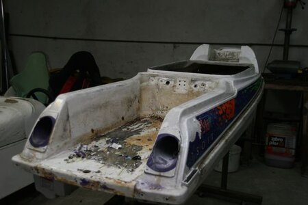

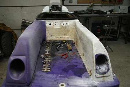

Engine removed and assembling parts:

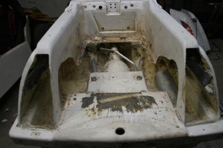

Poland
Ready for clean and mods

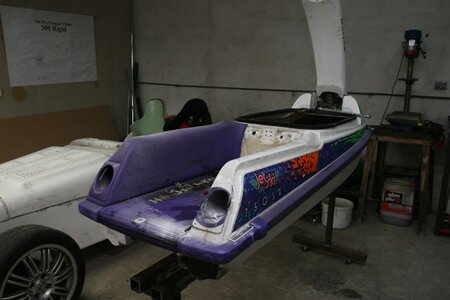

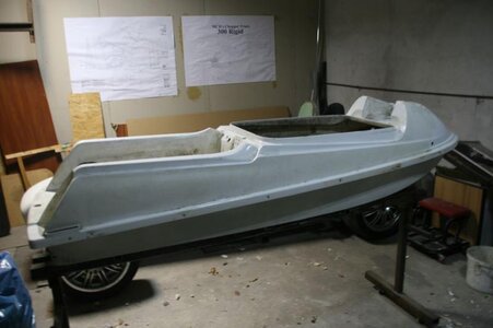

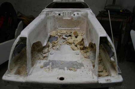

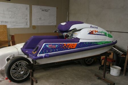

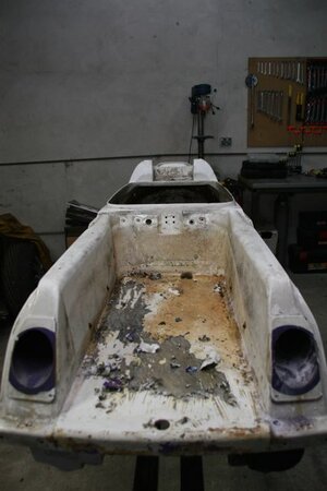

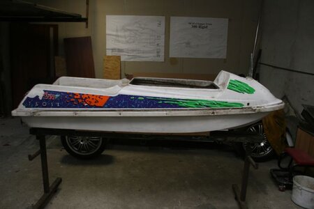

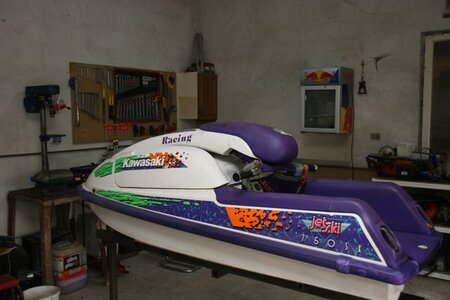

At the beginning hull lightening - complete ski wish weight 270ls
Shortening hull, D cut hull, no fuel external door, light hendlepole (3,5 kg), lightening and modify hood, 9 liter light (1lbs) cart tank, footholds, new foaming, turfing, custom painting.
Engine 82mm bore, ADA Head 180lbs, MSD Total Loss, Factory Limited Wet Pipe, Single Black Jack 48mm, full cylinder porting, crank case modify and epoxy.
Pump blueprinting, Skat Trak 9/17, 8/16 or anything what Dave from impros let me. Wet Wolf cone, X2 trim.

How many of those parts do you still need? I may be able to help out with a lot of them as I'm trying to part my 750 out.
BTW - Is that a Cataram kit car in the background?
i wouldnt do the no fuel door mod. its unnecessary weight if your trying to keep it ight.
other then that 270 shouldnt be a prob mine weighs 280
Poland

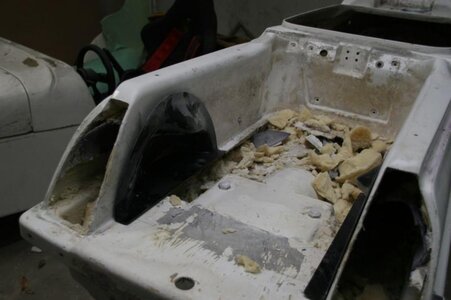

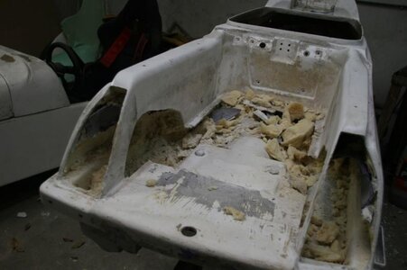

I will cut hull in place where is fuel door and put there thin fiberglass.
I weight only fuel door cover and it is heavier then example of piece fiberglas. I can not weight piece of hull witch will be cut of.
I am thinking about ping pong balls in close area where usually is foam.
Of course I would put in marine foam but first put balls to full and then fill with foam.
Balls are lighter then foam and would not absorb water.
I could earn 6-7 lbs.

I am about to start my 750 build. I am going to do close to what you have stated but thinking bout shortening the back not sure how much may be 3 inches. Taking out the exhaust (gunwhale) and running full 3" out.
Besides ping pong balls where else can you lose weight?
Glue on bond line?
Waternut
Customizing addict
Macon, GA
Glue on bond line?
Make sure you don't confuse 750's and SJ's. I shortened my SJ 3" and my 750 1". I love the SJ shortened and it handles like a dream for me. The 750 is very unstable above about 15-20 mph and very difficult to control in a sharp turn. Also don't defoam a 750, they don't absorb water like SJ's.
