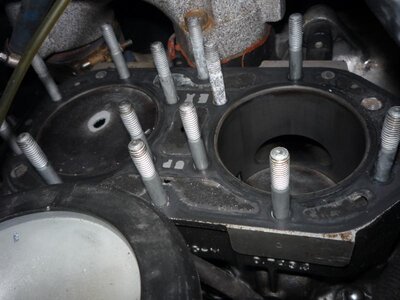

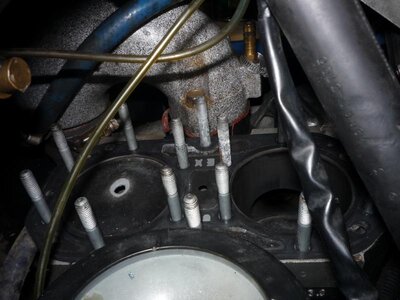

you might want to open up the jets a turn or 2
Yep...quite aware of that. Was in the middle of tuning it. Its pretty much my fault cause i didn't make him stop so we could check plugs. I just suggested it. Next thing i know he rides past me at wot and went that way for a bit and i got a sick feeling in my stomach cause i had a bad feeling it was too lean. Um...it was:skull2:
