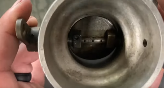

The idea of using the low speed as a main circuit reminds
me of the "Fish" Carburetor.
Bill M.

I suppose you could call it big low jet specs.
When the same rules used on the Sea Doo are applied
to a 44 or 46 sbn give a 140 low jet and a 130 to 140
main.
