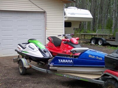

I've done this with a trailer built for a couch. Our Blaster was on the back, I had my FX1 perpendicular in front of it.
I never cared for it how it was set up but it got me by.
Later I put two skis perpendicular on a single place trailer with a tray in the middle for fuel, chairs, beach stands.
I can't find pics of any of them... well, here is the double parallel trailer hauling a pair of axles.... I called it the Beverly Hillbilly trailer.

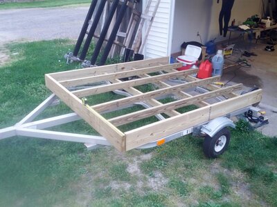

I built a wooden rack on a two place aluminum trailer last year for a B1 and two stand ups. This is the only pic I have ATM but it worked out pretty good. I carpeted the bunks, added stop posts on the front with winches, and a large plastic container for jackets/helmets.

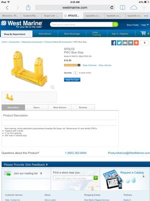

On the perpendicular ski and once your bunks are placed, every thing is where you want it tongue weight wise I'd fabricate out from the trailers frame to the nose of the ski with maybe 2in box and make an upright with a pin style bow stop. Attach a long piece of box first below your frame, attach to multiple frame rails with it extending out to just beyond the nose of the ski. Attach another 2in box piece to this and go straight up right in front of the ski, attach the pin style bow stop to this. Use a ratchet strap on the tail around the tray and bunks.
Blowsion sells a nice pin style bow stop that uses u bolts to clamp to your upright. Ebay has a bunch of different bow stops as well
