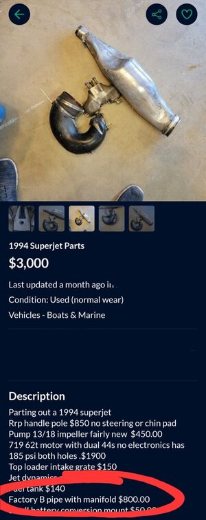

Ok I see factory pipes going for $1500 regularly, this guy's listed his at $800
Just wanted some advice as I'm still pretty new! Is this a steal or are is there something I'm not seeing?
Came off 62t, I'd be putting it on my 650SN.

They are about $900 brand new from Riva and Blowsion when they are in stock. That happens at least once a year. My guess is that one is already sold.
Just be patient and order a new one from riva or blowsion and wait for it. Paying 500 more for a used one than new that's probably pretty rough just so you can have it now is silly. That one for 800 is decent. I remember when used ones went for 5-600 range which is what they should still sell for regardless of availability. Or you could get the Chinese version from wax when its finished.
Keep in mind,62t has 10mm exhaust bolt holes. ur 650 cylinder has 8mm. There are ways around it. Another thing to ask when shopping used, has any part been "ported/gasket matched/ground on". I'd much rather have something that hasnt been touched.
