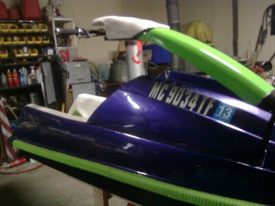

I bit the bullet today and ordered an x metal steering system. It is the fixed system "shorty: edition. It's -3.5".
I got the black system, with black straight bars and clamps. I have read nothing but the best about x metal and figured that I couldnt go wrong. Customer service was great i called them up and they answered all my questions and were very proffesional. Just wanted togive them a shout out.
For those that have the system, what do you think? Did I make a good decision? I am 6'3", so I figured the -3.5" system would be nice for me. My ski is stock right now. This will be the first mod. Followed next wek by a ride plate and workx grate!

you will love the steering system i have the exact same setup on my ski....all black fixed -3.5" and it is the bomb!....only problem i have is if you put the cable on the last hole out you have to clearance quite a bit for the stock rn chin pad as the cable rubs hard.

yup stock rn pole on my square...steering comes with 2 bushings and you use the one that fit's..has to be tapped in with a mallet cause it's a tight fit....and exactly the last outside hole gives you he most throw, doesn't mean you have to use it. and the plastic part right where the bolt holding the chinpad is...the steering cable hit's it...what i did...to get enough clearance so it won't bind on it..mine still rubs a little bit at full throw. i ground out the plastic just above the nut that holds the chinpad down. then i mixed up some epoxy resin with some 404 filler and gooped a little on there and made it a semi circle. that way the nut was still solid in place and there was room for the cable...you have to take out just enough material that it looks like the nut will no longer stay by itself, and the area the nut is in is hollow so i made it solid with the resin concoction and shaped as needed
Will the round nose pad have the same problem? I have never seen the bare plates, but theey are different shape I assunme. If I run into the problem, I will copy your idea. I appreciate the input. One less problem to surprise me!

yes it will i have a stock rn pole, pad, and bracket on my sn. i am also running the xmetal billet throttle on my ski as well.love everything about this whole setup. i rode a budd'y ski with a stock steering on it last week and was amazed at how crappy it felt and hw much the stock turnplate felt like garbage..felt like the steering was broke. i'm hooked on this steering setup
man thats good to hear! I think it will really help me move forward . Im still learning the stand uop ropes, but Im loving every minute of it. With this steering, a plate to keep the nose down and my grate i figure it will be much easier!

I just installed the adjustable system on my FX1. The factory bushings were shot, so I figured why not just upgrade the whole thing.
My plan is to play with the adjustments, and if I want it shorter, i'll chop my poll a couple inches, and then bring the bar back to compensate and find perfect length for me. We'll see how that goes LOL...
I think the steering throw adjustment is different on mine, but I had the same issues with hitting the chin pad. I used a angle grinder and notched it out. The retainer nut isn't affected.
I haven't ridden it yet, but just turning it on my cart it feels sooooo much better. Defintely great support from Xmetal and a awesome product.
