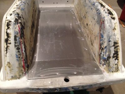

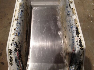

I know for a fact it's not the tray. It was not reglassed. An aluminium plate was cut. Silicone was placed all the way around wher the tray will sit. Then it was riveted on. The the edges were siliconed again overlapping the tray and the plate. I have pics of the whole process for when it's time to sell the ski. Also when it was in the water the tray almost never got wet. The water was too cold to really play. And the tray was way out of the water when on the scissor stand. Gonna try watcons suggestion.

post up some pics of how you sealed up the tray.

Here are the pics. I used clear but you can see the smear marks around the edges and from hitting the rivets. Now that im also on a computer and not my phone at work I can properly read messages. When I defoamed it never sealed up the bondline on the inside. I never thought of it. I used a wire wheel on a die grinder. The bondline was clear and could be fully felt. Did I screw up here by not sealing it?

Never seen a tray done like that so I cant comment on your method
