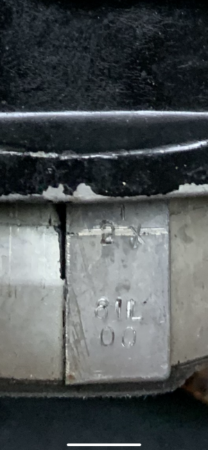

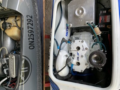

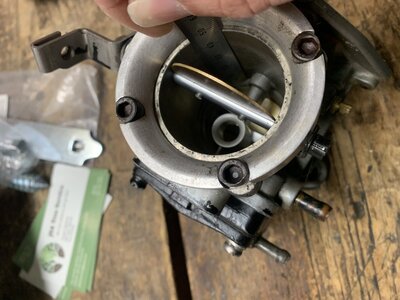

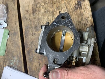

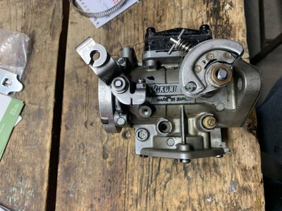

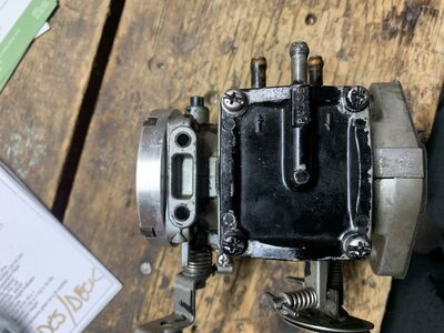

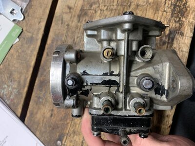

Hello everyone I have a mikuni carb that came on a 760 (61x cases 62t cylinders bored and ported) previous owner used non fuel rated hose and the carbs all gummed up, but I cannot figure out exactly what carb it is for the rebuild kit I need, it looks bigger then my 38s on my super jet, any one have any idea? Also what would be a good jetting for this carb for a 760cc
Any help would be appreciated, thanks in advance

I don’t have a carb answer and not to derail . But , is that white motor powdered or painted
Ontario
That looks an awful lot like a plain old stock sbn44 like what normally comes on a 61x bottom end to me.
There’s a good enough chance it is, I just wasn’t sure if there was any stamping to look for or indicating signs I could check before I order the wrong kit lol
