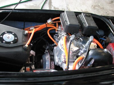

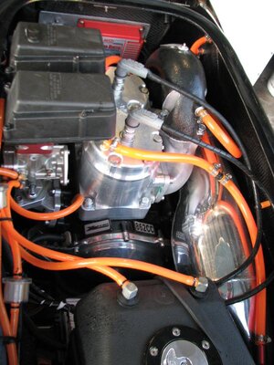

I'm running a 6mil/ADA Xscream motor, b pipe, dual xs 46's, TL on avgas. . Love the power, very smooth from first hit & pulls hard all the way up. Great surf motor becuase of how smooth the power is! I can this motor my sewing machine its so smooth.
