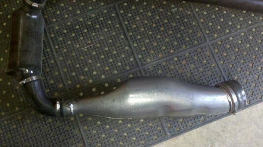

Super Jet Are these pipes LIMITED or MOD FACTORY PIPES?

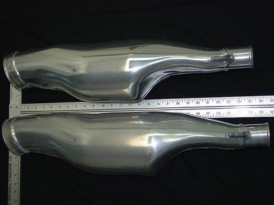

Photo 1-both pipes together for comparison(JUST AN EXAMPLE, Nither pipe im asking about is in that photo)

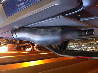

Photo 2- Black pipe in photo alone- what is it- Mod or limited?
Photo 3- silver pipe alone- is it a mod or limited?

Hard to tell be looking, but the second pipe in pic two looks like something may have been changed at the stinger. The welds look a bit different than stock. My limited has been played with a tad, but measures 26" overall. The mods are a bit shorter. I'm guessing the pipes in pics 2 and 3 are limited, but not sure.

there limited if its a mod there should be a weld going around the pipe were they cut it at lest that's the way i understand it mabe im wrong about that

Total Length
Mod Pipe = 25-1/2"
Limited Pipe = 26-1/2"
Circumference
Mod Pipe = 19-1/4"
Limited Pipe = 19-3/8"
Diameter
Mod Pipe = 5-3/4"
Limited Pipe = 5-7/8"
Volume
Mod Pipe = 212 US [fl oz.] or 6.270 Liters
Limited Pipe = 232 US [fl oz.] or 6.861 Liters

Hard to tell from the pics, but I would say it looks like the black one is a limited and silver is mod. Use the measurements Mdavies gave you and you should be good.
