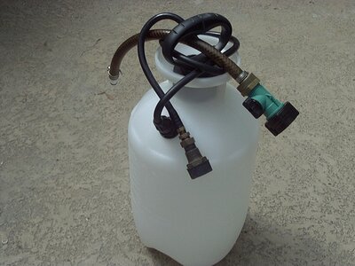

I want to put a fresh water tank on my trailer to be able rinse off my ski and clean up after I'm finished riding for the day. I have seen plenty of people with them on the beach, wanting to find out what types of pumps and power sources are being used?

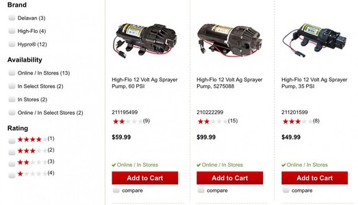

Rural King. Spray tank pump 12volt. Just wire the pump to a trailer light connector and plug it into your vehicles trailer light hookup. Turn your lights on... Powers the pump. Done

id either grab an inverter and a aquarium pump, or a 12 volt and run it to a washer wand. Good idea, would probably have a 30ish gallon tank on the trailer.

Awesome, thanks. I just need to find a decent tank at a reasonable price.
