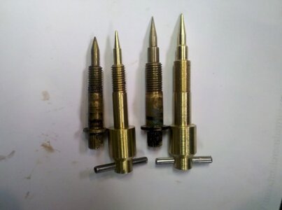

If your stock screws are under brass caps, after you remove the caps, the screws are hard to reach. They are flat head and can be accessed but they are challenging to reach. Replacing them with tee screws can making tuning much easier. It's not a necessary expense if you are on a budget, but it is a luxury I enjoy. If you can already access your screws well, ignore this.
The screws that hold the diaphragm cover on, which is what covers the jets (not the kidney shaped item inside), and the ones that hold on the fuel pump, opposite side of the jets, can be replaced with Allen head screws. Again, this is not a required change if you are on a budget. You can also order them from McMasterCarr or buy them local. I just found @JetManiac to be affordable and simple, especially when ordering other stuff anyway. I upgraded to these on JM suggestion because I could not tighten my fuel pump cover down tight enough with the Phillips to get my pop off leak tests to spec. Also, they remove the whole screws getting stuck and the heads stripping annoyances.
Again, these items are not absolutely required, but if you have an extra $50, they are nice to have. JM can also set you up with a ADA gilded head kit, jets, and some helpful advice most of the time. His advice has been a great starting point and troubleshooting for me, but just remember you still have to do the testing and tuning yourself.

That was just an image I grabbed off google to show what tee screws are. I learned my lesson. Not hing goes in Munich carbs that is Not made by mikuni.

Thanks for your advice and all the information I truly appreciate your effort! Getting the tee screws makes perfectly sense to me and is just a matter of time (still to cold to ride anyway) I was already wondering how you guys reach the screw and make precise adjustments while tuning since the space is so limited. I will definitely hit up JM just going to wait till I know all the parts I need/want for shipping reasons. Was also thinking on getting the tee screws for the b-pipe from JM.
With the diaphragm cover screws I did not have any issues but I guess they will be on the list just in case also getting parts in germany can be a pricey bitch.... ;)
Dual cooling was not on the list to do...I was under the impression its not necessary for a 701 with running in "normal" water temperentes please correct me if I am wrong. Dont really want to pull the pump and do everything if i can spend that time on the water :)
When I installed my pipe I could not get the manifold drilled/tapered due to metric vs imperial systems......I spend 3 days running from shop to shop trying to get the right drill bit and thread cutter got sold the wrong one twice(due to conversion error by the sale guy) and almost started drilling. After I could not find a single machine shop or sales shop that could help me out(sell or do the work)I had no choice but to slap the manifold on as it was. Also I thought it cant be to bad with only one line going in since the factory sells them like this for a long time and should have changed it if it was crucial for the 701?
Also after installing the manifold I am not sure if I can actually get the bitchy screw out without any major effort (the screw from manifold to cylinder) cuz the bold head is not in the best condition and it sits really really tight felt like screwing in/a virgin :D (and yes I modified my wrench to make it work). Advice for any guy installing a manifold on a used cylinder head take a thread cutter and clean the threads before installment. I guess the would be a must for dual cooling and soon or later I will have to mess with it probably anyways just trying to put off as long as possible ;)
Also if I use the tee screw for the carbs will the be one to one the same turn wise as the mikuni screws?

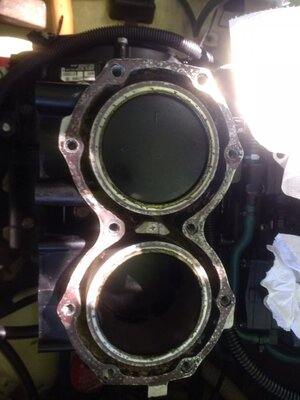

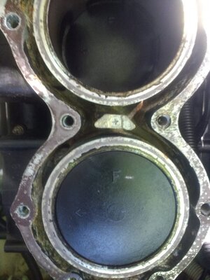

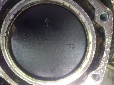

After pulling the head I took some pictures of the pistons unfortunately the quality is not very good. To me as a non knowledgeable person the combustion looks "even" with no hotspots. Since I am upgrading I have to change my carbs settings finally. I ran more than one season with the 130 high's. The location is 18 meter above seelevel and temperature range from 10-35 degree Celsius. I guess it just underlines how different the jettings can be from boat to boat even if they are completely identical part wise.
Germany
Here are the pics
