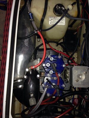

Here's how I have my lines. Top of the pipe T-ed to the pisser and stinger. Bottom of the head pipe to the head and from the pump T-ed to dual cooling on the bottom of the manifold.

Did you shorten the top two center bolts on the manifold? Mine always seem to need to be a bit shorter than stock...
I did not. That might be another issue. Those were giving me lots of trouble on getting them tight. I ended up tightening them enough so the manifold could still slide up and into position. That way I didn't have to tighten much because they were such a pain to tighten with the manifold in place. I might try shortening them and see how that works

It's possible that they are hitting the manifold and not allowing it to sit flush against the cylinder. Get a couple slightly shorter ones and a cheapo wrench that you can grind down to slide in there better.
The trouble was getting a wrench on the top center bolts. I will try grinding one down and getting in there. I also picked up some stainless Allen head bolts to try as well. I think I would have enough room to get an Allen wrench in there too or cut it down if needed
