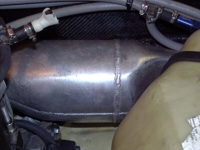

P1040828.JPG As stated above, the mod version is 1.5" (38mm) shorter. Years ago I shortened all my ltd pipes 1 3/8" so they're easier to install. Clamped them down, took a hacksaw and removed that amount . Welded back together, see pic.
