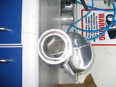

Chucky has a modified limited pipe that's top secret he uses on his skis. :sneaky:

Hey Chris does that chamber have a "water jacketed" stinger to cool the stinger, but keep the actual exhaust dry?

Yep! That's top secret...Not now!!! But just what you see isn't the whole package, and too bad Dan and Chris both don't have the secret package :cool2:
