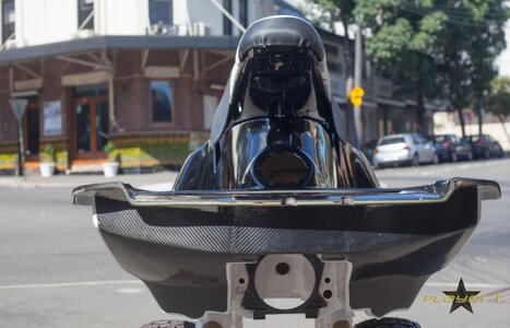

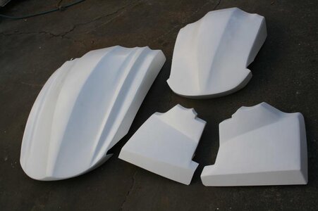

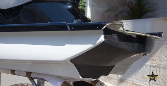

Blasters land tail heavy a lot more than stand ups and are more difficult to properly recover from a landing once they have been shortened. Obviously the benefits of shortening a blaster are well worth it, but many people hate how unstable they are at low speeds or getting back on easily in surf. With the top deck staying full length at the tray, it aids in the stability while trolling along slow and using it to level out the hull better than a straight cut off the back. Also it provides a normal sized tray area to climb up on with your knees etc. When on plane or jumping a wave, the full length of the top deck will never make contact with the water so its back to feeling short with super quick steering and the much increased ability to flip around! The flat straight-cut rears often crack and fail due to such a large flat surface impacting upon every landing and eliminating the bond rails where the glue seamed the top and bottom deck together. More angles.... more strength. I also positioned the rear angles to create more self up-righting of the hull upon landing to correct how easily blasters want to topple over with the higher center of gravity. This is seen amongst most sit-down skis after the era of the wave blaster and was continued on many sit-downs thereafter. ( slight V seen in pic looking straight at the back...3rd pic)wb ass1.jpgPlayer1-4-3.jpgPlayer1-3-3.jpgIMG_0465.1.jpgnose rox.jpg

My Rear tail panels are only $200 and come with templates to guide where you will cut your hull and an install guide with step by step pictures, making it no harder than footholds really. Feel free to call me anytime or shoot me a message if youd like 407-730-1050.
Trebsdub, Carter makes a great kit for an easy cut and glass setup on what he has posted above. I like the straight cut, the rear of a blaster is definitely week, but much of the damage that comes on the rear end is due to the forces that are applied to the rear lip of the ski rather than to the vertical surface as it meets the water. The upward pressure when you land tends to bend the lip upwards, weakening and cracking it over time as you jump (and jump you will!!!).

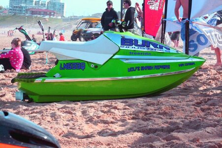

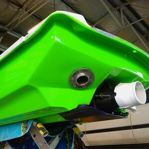

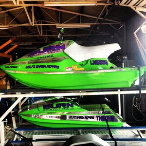

I cut my hull -3 following the contour of the original hull (considered the straight cut) and removed the rear lip. 2+ years later the hull is still in great shape and extremely strong. The straight cut has survived many big air landings, backy flat landings and sand bar hits without issue.
The straight cut requires you to be extremely nose high to put the rear of the hill parallel to the water surface where the hardest hit would cause damage.
When I cut my hull, I found it easier to recover from big airs as believe the slight reduction in bouyancy in the rear of the hull eliminated the well known "blaster bob" that is difficult to fight on many landings without falling off. My hull tends to land, sit and then I am able to power away without an issue, it does not land and then "bob" back out of the water and unhook the pump.
You should definitely take the opportunity to ride a few versions of what you think you might like to get a better understanding of the handling characteristics prior to picking up the grinder, know before you go and make sure all your hard work gives you the desired handling characteristics you are seeking.
My next build will include a straight cut rear, with a small lip, probably just enough to get my fingers under it, but not enough to give the water something to break off like the stock 2 inch plus lip ( it is necessary to get the ski off the beach, no lip is a pain).

Rear kits install very simply and really require no expertise in fiberglass. Feel free to call or email me for the install guide for a better idea of whats involved. The nose is also quite simple to install but will be a little more time consuming, but still nowhere near the time it would take to do it all from scratch and guess on what shapes are going to work. If you can install footholds you can do these :)

ill bring one bone stock with rear only mod just to show how insane it is to anyone who wants to demo it. also i will have a front and rear mod blaster with a pipe and prop on it to show it will flip :) Bring me some beer and come have a ride

The carter b rear mod is very nice I over rotated a flip and landed on the tail on my mates ski and it just rode away very easy but on my ski which has just been shortened not angled I wouldn't of been able to ride away
