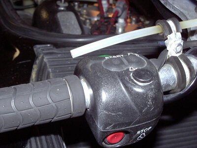

3-way rotary on the SJ. On the Blaster I took a toggle switch with a boot seal, soldered on the wiring, then coated the case and solder joints with epoxy and attached it to the underside of the start/stop switch. Nearly three years and it's still working like new. Not the prettiest thing, but it works great and cost under five bucks.

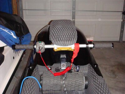

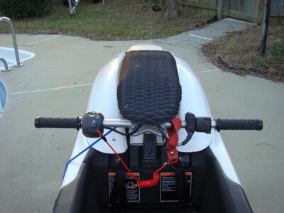

on my sj, it came with the blowsion switch that mount under the yamaha start stop. on my kawi i just used a marin toggle on off switch and i mounted in on my handlepole under the bars. they actually sell them at my supply house....$5
