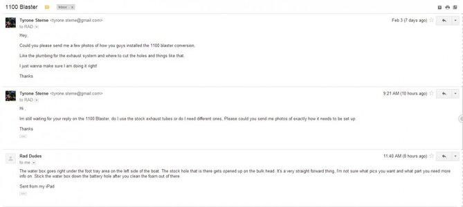

Email came in a 2:21am I emailed you back at 4:40am when I woke up. Sorry I wasn't sitting by the computer to reply as soon as it came in. But thank you for posting on a public forum that we don't reply to emails when the opposite is the case.
And proof that I emailed back just over two hours later and at 4 AM.

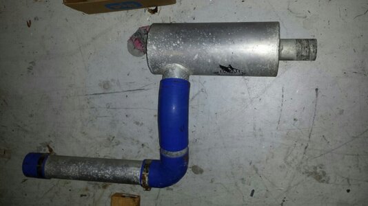

If you are utilizing oem parts from the ZXi you can utilize the tube & clamps going over the pump tunnel, cut the rear exhaust pipe leading up back, u can use the oem ZXI rear exhaust outlet and flapper these are quite cheap even to order new , also the little connector pipe coming of stinger, turf or unbderlay the areas where the waterbox will sit, if you go fancy u can use oem rubber strap and put that in place in rear. I have the Rad Dudes kit on mine fell free to contact me with any questions they had been very helpful to me.

Okay, Twinturbo . Please go check your emails carefully before making a fool of yourself. I asked more than a week ago and got no reply! You then only responded to my 2nd email. If you went to all the effort posting peoples emails on the forums maybe try read them and respond to your customers, I am just asking a simple question and you have not been helpful at all.. Orangefinger explained exactly what I needed... Thank you (which I am sure you where capable of doing?)
You Have not been helpful with all do respect, even from the beginning . I spent over 1000$ with you and then only after paying I had to wait weeks before you shipped my goods( you didnt tell me you didnt have stock?). I waited patiently and didnt make a scene, the least I could ask for was a little bit of help and information. Thats all I was asking for , how hard would it of been for you to send a few photos of your builds, I am a paying customer and you could of treated me with a little more courtesy, look at your blunt sarcasm in this forum post?
"Good luck with your build, sorry you couldnt figure out how to put a water box in." What are you implying by that, I was asking more than just how to put a water-box through a hole, I was more worried about how to plumb it correctly and which side as I have never done it before! Sorry for asking a simple question...
I asked more than a week ago bud. Get your facts straight.

I think if anything we reply to emails and post helpful posts on these boards more than most. So the looking like a fool is all on you. I have reply emails to everyone you sent all within hours just like I posted above. What other companies are replying at 5am?? Give me a break.

Well everything makes more sense when you lay it out on the ground like Chris03HD showed above. I also used Chris's wiring diagram for the E Box (very helpful) Like Byeai said, PWCtoday has quite a few B1 1100 builds to gather information from. You are welcome to PM me if you have any questions.
