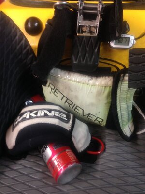

The retriever is a floatation bag with 50
Or 100 of rope inside. You mount to
Hull with the Velcro it comes with and or a Velcro strap if ordered that way. Deploy manually when you get in trouble so if the ski goes down you at least know where it is... watcon has some with 50 ft rope, not sure if he has the mounting strap, but comes with Velcro for sure.
Here's a pic, I have the strap off right now. Kinda hard to find but fast elements had some......,

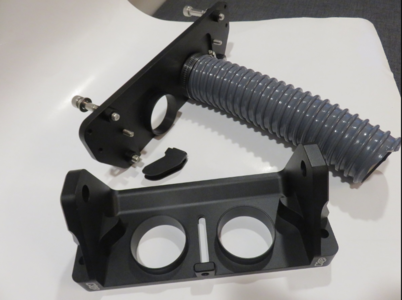

you probably don't want to change brackets .....but spigot mounted tubes on the bracket & the underplate seal well.
And why wouldn't I have known somebody did it the right way. Who makes that bracket? I was thinking of a grommet but that take care of all if it in one shot.
Knoxie
www.kp-parts.com
New Zealand
shipping a bit costly unfortunately...would end up being around $300USd to your door.
Tubes are 2.25" outer diameter (2" inside). ..not sure what the blowsion pole can accept
