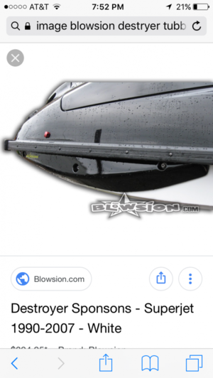

Something isn't right. When I did mine on 01 RN they looked like this installed And are oriented like this. Countoured pretty good to hull also.
Can't tell from your pics if yours are oriented like this or what ?
Only thing I can think of is check orientation against this pic and make sure ski doesn't already have glassed on tubbies....also the 08 RN has built in tubbies... could your hull possibly be a late built 07 with tubbies or early build 08 marked 07
