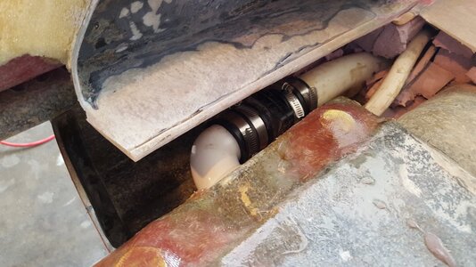

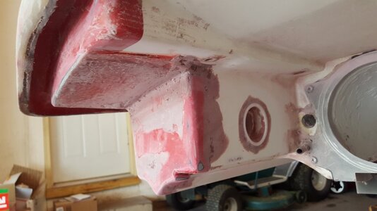

XFT had recessed scuppers over 10 years ago. People where putting internal one way valves in a long time ago, not sure why that trend went away, I've had one in over half of the hulls I have owned with zero issues plus they are spring loaded so they seal very well.

I think the thing with the one way valves was when they break you have to cut your tray open to get to it to replace it. Anything you can do that works and you can get for maintenance makes more sense
