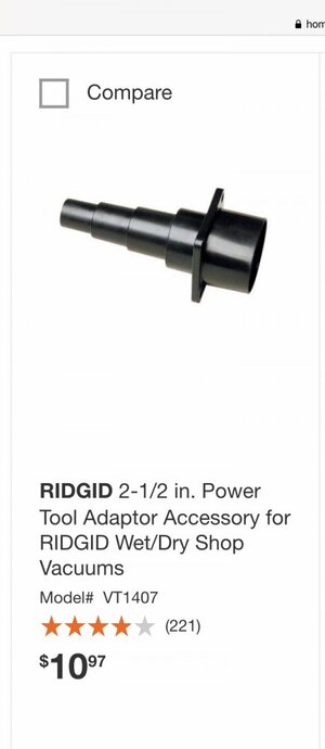

Curious what everyone is using for breather hose attachment. I couldn’t come up with much after quite a bit of searching. I use these from Home Depot as they have a flange with 4 holes for easy riveting and I can put sealant on it prior to riveting making it water tight. The blue vac hose fits well and with the reducers you can cut and fit what you prefer/need and it looks clean. I also like that I can install it with one end higher up in the hood to reduce water intake. I wish the flange was thinner but it works. Any better or cheaper alternatives out?
I just drill the hole out and clearence them a bit and glue in with windshield urethane. You'll need some sort of fixture to hold in place while it cures. There were a few retailers that sold flange kits at one time (havent checked around recently), showtime freestyle, blowsion to name a few.
