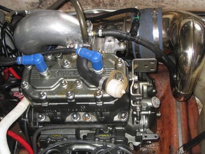

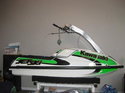

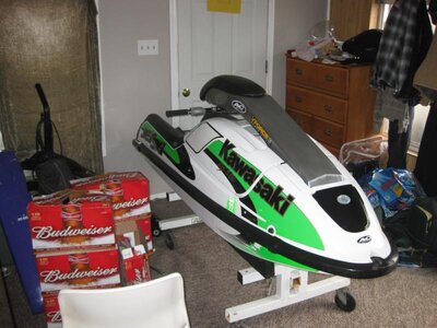

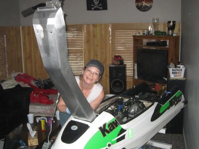

well i am building up my 01 sxi pro started with a new aluminum handlepole cuz i broke the stock one, then i went for v force 3 reeds and i got an r&d mod pipe, i am still looking for a factory limited pipe if anyone has one, took the chokes out and put in a primer, got footstraps but waitin till first ride b4 i decide where to put them , i'm still waiting on blowsion flame arresters and i'm making my own handlepole restraint rope any other useful and prefferably cheap mods you can think of let me know
here are some pics from stock to know with a little help from mom in the hard to reach spots

haha thats funny but actually thats my house and she happened to be by on a visit and soccer sux but anyway have you guys got any suggestions wen it comes to positioning footstraps all the way back ? staggered? ect.
what do you ride most? flat or surf? flat i would go all the way back or footholds. if you ride in surf then surf stance. i would put in some footholds too. its probably the most important part to a freestyle boat IMO.
i ride flat most of the time but we get a lot of big boats comin throuigh our river u can get sum pretty wild surf conditions on certain days out in the lake (huron) but u think the straps arent enough ? fottholds are a must?
grasshopper
Wax on Wax off.....
Cocoa FL
Finally some one else with the same goofy pipe as me! I have seen them for sale but I have not seen one in a ski... How do you like it what carbs are you running? stock? As far as footholds and straps you can always run both if you want or a combination of the two...
for flat i would put em in the back. footholds aren't that important, its just that for me, i like a wider stance and i like the duck stance u get when in the holds b'c thats how the bindings are on my snowboard, with my toes facing to the nose and tail of the board. it's all personal preference though. are you keeping the tray pads in or turfing the entire tray?
to answer the first question i am runnin it with stock carbs which are dual 40 mm mikuni but i am changin the pilot jet to an 80 from 75 the thing is there is ice bergs in the river rite now so i cant test it till its get warm again
and the other answer is i wanted to put the pads backin because i had a set custom vinyled with a cool stich pattern but turf is not out of the question i would hate to wreck my expensive vinyl job

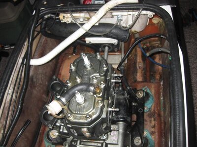

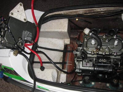

the build is goin backwards now
looks like thebuild has gone in reverse now with a factory pipe comin and the ski bein half empty mr superjetkev has persuaded me to empty it bare and paint the inside jus about to take engine out
